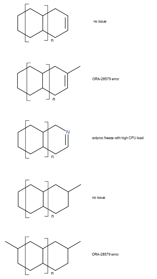

BIOVIA recently discovered that the creation of a BIOVIA Direct chemistry index may fail with a particular type of structures. The problem will manifest as a hang of the underlying extproc process with a high share of CPU time in that process, or as a crash of the index creation process with an Oracle error 'ORA-28579: network error during callback from external procedure agent'. The following image shows a few examples of impacted structures to illustrate the type of structures.
The common denominator of the structure is the two fused rings with a polymer bracket, the failure depends on the substitution scheme of this core.
