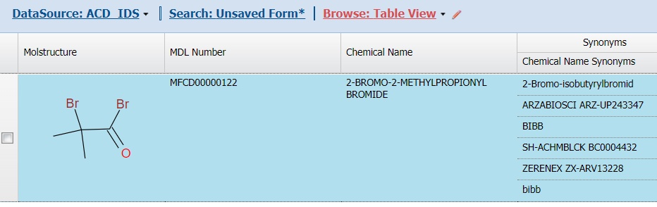

The screen shot below shows the synonym names are displayed correctly in Insight:

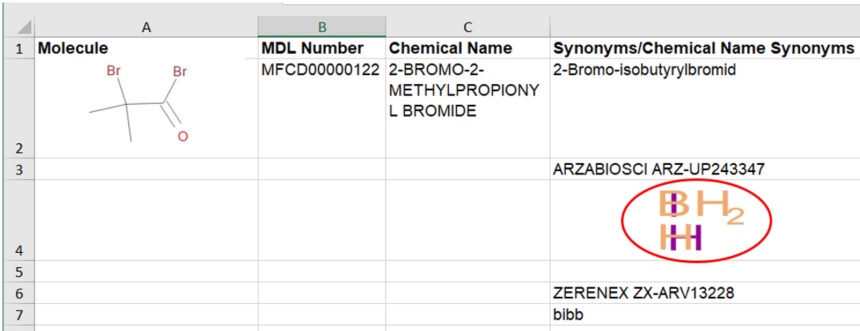

This screen shot below shows the issue with the BIBB synonym converted to a chemistry image after it was exported to Excel:​​​​​​​
