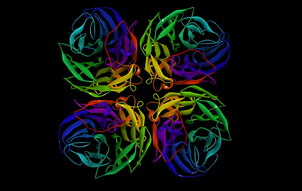

This script provides a way to rainbow color a protein by chain. (i.e. each chain will be colored from red to purple)
PURPOSE: The following script works on an open Molecule Window containing a protein molecule. It colors each chain of the protein from red (N-terminus) to purple (C-terminus)
