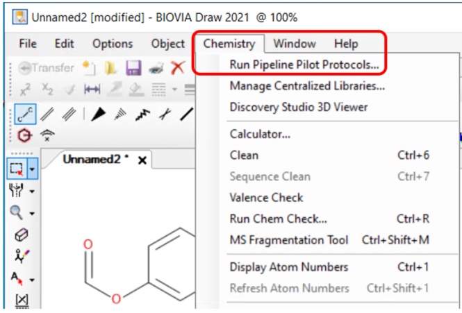

Users can run separately installed Pipeline Pilot protocols from Draw by choosing Chemistry > Run Pipeline Pilot Protocols.

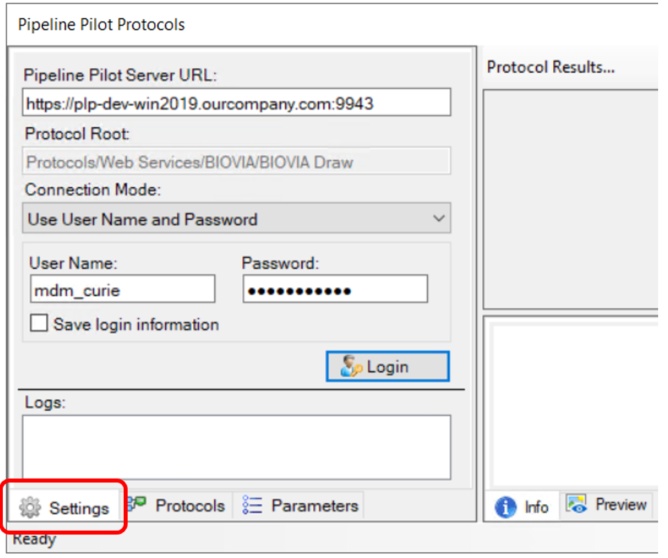

  • For the Pipeline Pilot Server URL, use the URL for the Pipeline Pilot Home page, for example
               https://plp-dev-win2019.yourcompany.com:9943
  • Click on the Settings tab to use a different Pipeline Pilot server.
  • The Protocol Root folder settings are in the user’s registry. See the BIOVIA Draw Help for information on how to change the root folder.
Settings tab
Chemistry > Run Pipeline Pilot Protocols:

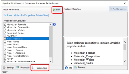

Choose Next for protocols that require parameters:

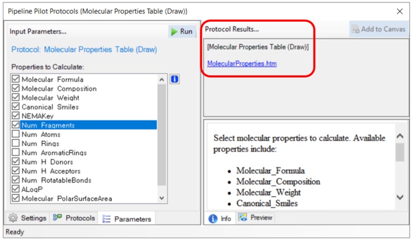

After selecting your desired parameters, click Run:

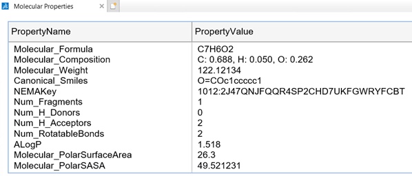

Example Results:
