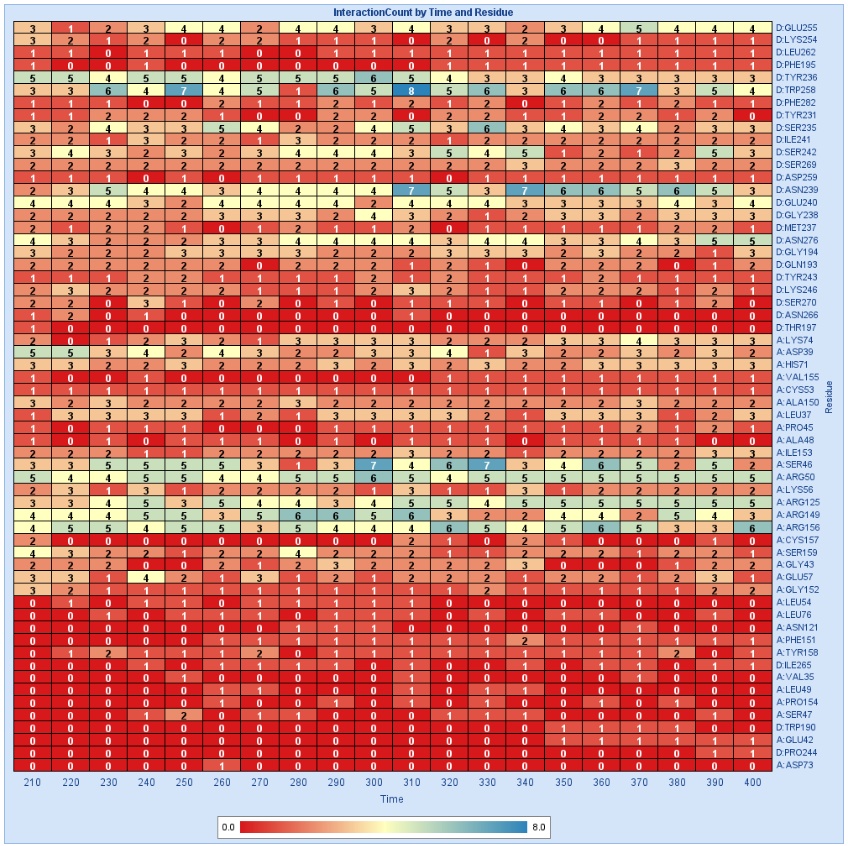

This protocol creates a Heat Map showing the number of interactions involving interfacing residues over a trajectory. The protocol parameters are the same as those in the Analyze Protein Interface protocol. The output is the Heat map plot (similar to the one shown below) in the job Report and a csv file containing the same data. Beware of using a trajectory with too many conformations otherwise the Heatmap will just a black box. The one below contains data for 20 conformations.
