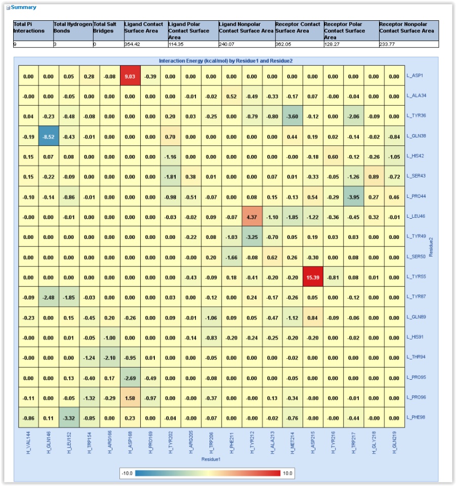

PURPOSE: This protocol allows you to elucidate the energetics of individual residue pairs at the interface between 2 protein chains. To do this, it combines the Analyze Protein Interface and Calculate Interaction Energies protocols. The results from the Analyze Protein Interface are reported and the resulting groups "Interface Ligand Residues" and "Interface Receptor Residues" are used in the next stage which calculates the residue-residue interaction energies (vdw and columbic) between every residue in the first group with every residue in the second group. The resulting Heat Map shows energetically favorable interactions in blue and unfavorable interactions in red.

Example of the Heat Map generated in the Report:
