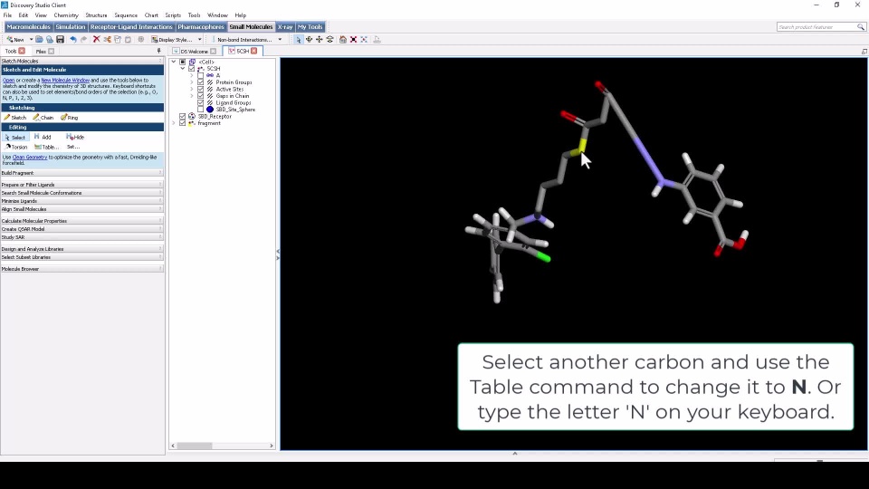

[How to] connect 2 ligands in a receptor with a specific linker in Discovery Studio
This short video demonstrates how to manually add a linker chain between two ligands in a receptor-ligand complex. The linker atoms are minimized to remove any close contacts with the receptor but further conformational searching could be performed using dynamics with or without constraints/restraints.
