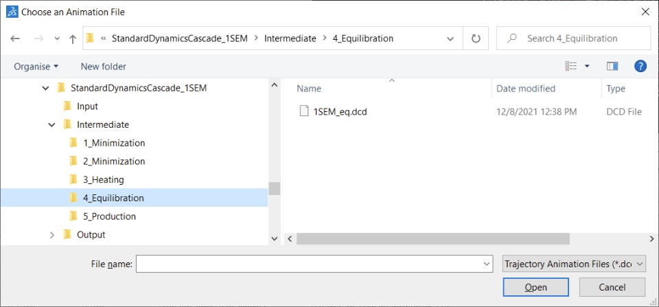

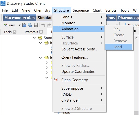

2. Go to the Structure>Animation>Load menu.
3. In the Choose an Animation File panel that appears browse to the *_eq.dcd file in the Intermediate\\4_Equilibration folder for the run and click Open. This adds the equilibration trajectory frames to the Conformations tab of the data table. You can now plot the energies against time or step number using the Chart menu options.
