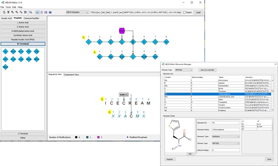

The classical Java based HELM Editor by Pistoia was integrated with several BIOVIA applications already many years ago. It is based on a monomer library that is locally installed. Meanwhile a newer Javascript version exists.

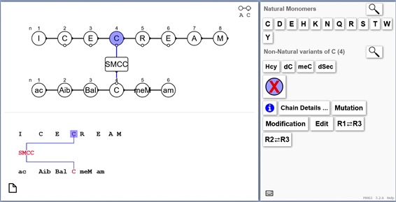

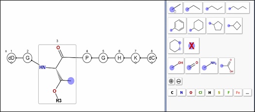

With Pipette BioSketcher a new state-of-the-art HELM editor exists from BIOVIA. Pipette supports small molecules, reactions and HELM sequences. It is an intuitive sequence builder with well defined attachment points and is available with BIOVIA Registration, Insight, Pipeline Pilot, Draw, ScienceCloud  and on the 3DExperience Platform.
