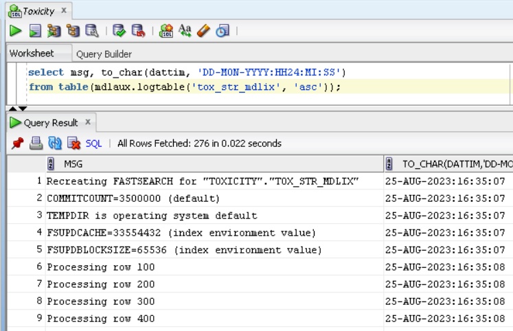

For example, if the domain index name is TOX_STR_MDLIX, you can run a query such as the following to check on the status:
select msg, dattim
from table(mdlaux.logtable('tox_str_mdlix', 'asc'));
where the MSG column will include the rows processed, and the DATTIM column includes the date and time.
If you would like to include minutes and seconds from the DATTIM column, you can use the Oracle TO_CHAR function, for example:
select msg, to_char(dattim, 'DD-MON-YYYY:HH24:MI:SS')
You can sort descending (‘DESC’) if you prefer to see the most recent rows processed first.
Here is an example of the first few rows processed:

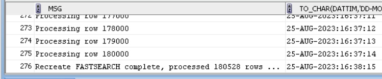

This shows the procedure has completed:
