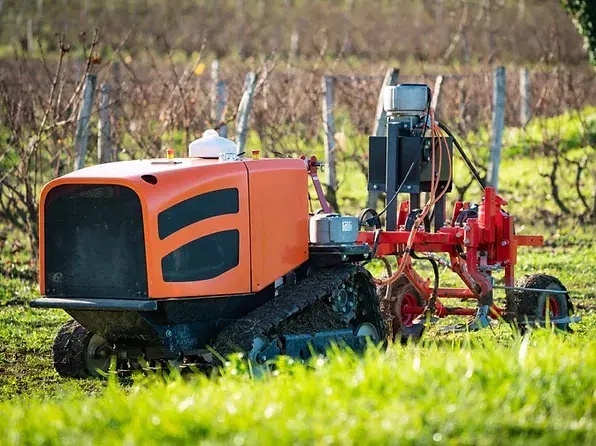

AgreenCulture is a Toulouse-based company that designs, develops and produces autonomous solutions for agriculture. AgreenCulture’s ‘CEOL’ robot is guided by a special device called AGC Box. The device fuses various sensor and positioning input data and includes a GNSS RTK module developed by the company. The result is automatic, centimeter-accurate steering, making machine automation affordable for smaller farmers.

The AGC Box can guide a single or a fleet of robots, constantly calculating best trajectories while avoiding obstacles. Real time kinematics allow the robotic device to adapt continuously to the complexity of fields and crop layouts.
