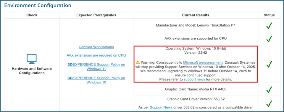

Consequently to Microsoft announcement, Dassault Systemes will stop providing Support Services on Windows 10 after October 14, 2025.  We recommend upgrading to Windows 11 before October 14, 2025 to ensure continued support. Please refer to support news for more details.

Cloud Eligibility Checker does take these changes into account in Hardware and Software Configurations check as per below:
