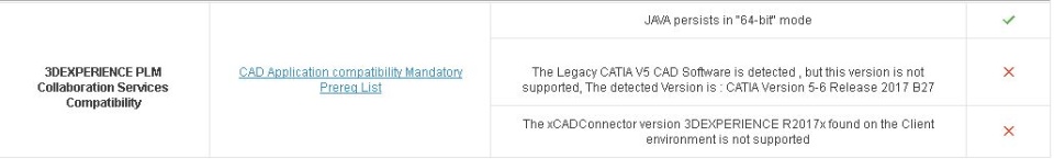

[2] New Check: Integration of “PLM Collaboration Services” prerequisite check
The mandatory prerequisite check for use of “PLM Collaboration Services’ provided by DASSAULT SYSTEMES on cloud can be validated using Cloud Eligibility Checker Tool
In this version, both below PLM Collaboration services apps for related CAD Software applications are implemented:
PLM Collaboration Services for CATIA V5
PLM Collaboration Services for SOLIDWORKS
The Prerequisite checks are
- The Supported CAD Version level
- JAVA level and bitness mode
- xCAD Connector version
The Cloud Eligibility detects the installed legacy CAD software application version and validate it against the DS supported CAD version on Cloud and provide the OK/KO status accordingly.
In Similar way, for JAVA level along with bitness mode and xCAD Connector Version check.
Notice that this check is enable only when legacy CAD software application
(as of now either CATIA V5 Or SOLIDWORKS) is installed Or present on the system.
The value of such implementation is to promote such checks to our Cloud users only when necessary and to not impact the report for our Cloud users which are used to our current 3DEXPERIENCE Platform Cloud eligibility checker.
Accordingly, a clear Message displayed to the user at the top
Please note, the status computation of this check is not considered in Global Message computing.
The Global Message displayed at the top is still indicating the System readiness for Cloud solution deployment only and clear warning message shown.
