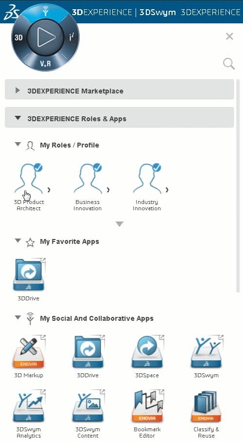

In the 3DEXPERIENCE platform, you can easily and quickly retrieve access to your most used apps by adding them in the "My Favorite Apps" section.

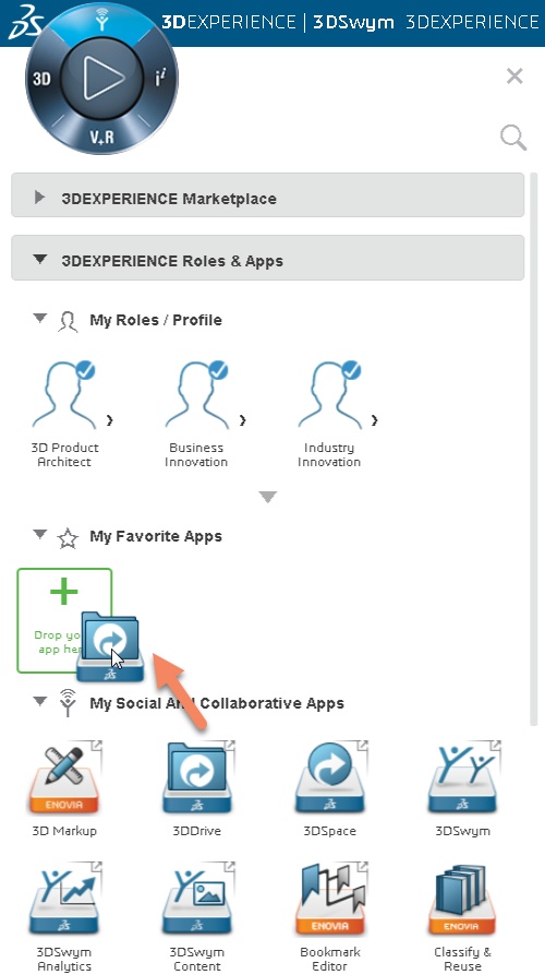

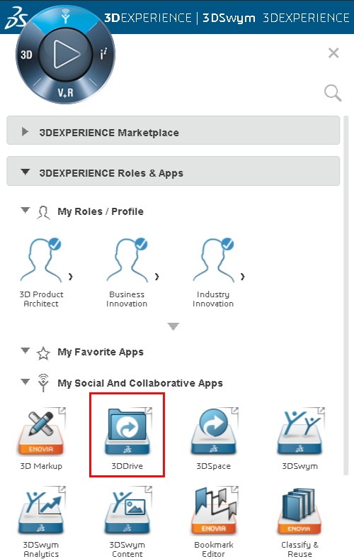

1. Choose the app you want to add in the favorite section. Here for example, we'll add the 3DDrive application, in the North quadrant, to the favorite apps.
2. Drag and drop this app on the "My Favorite Apps" section.

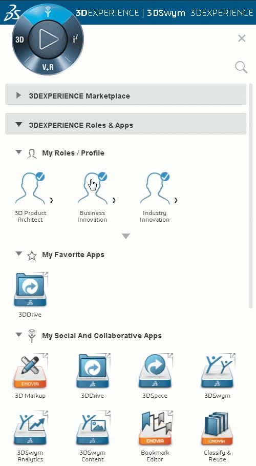

3. You can use roles to set favorite apps. All apps associated to the role are added to My Favorite apps.

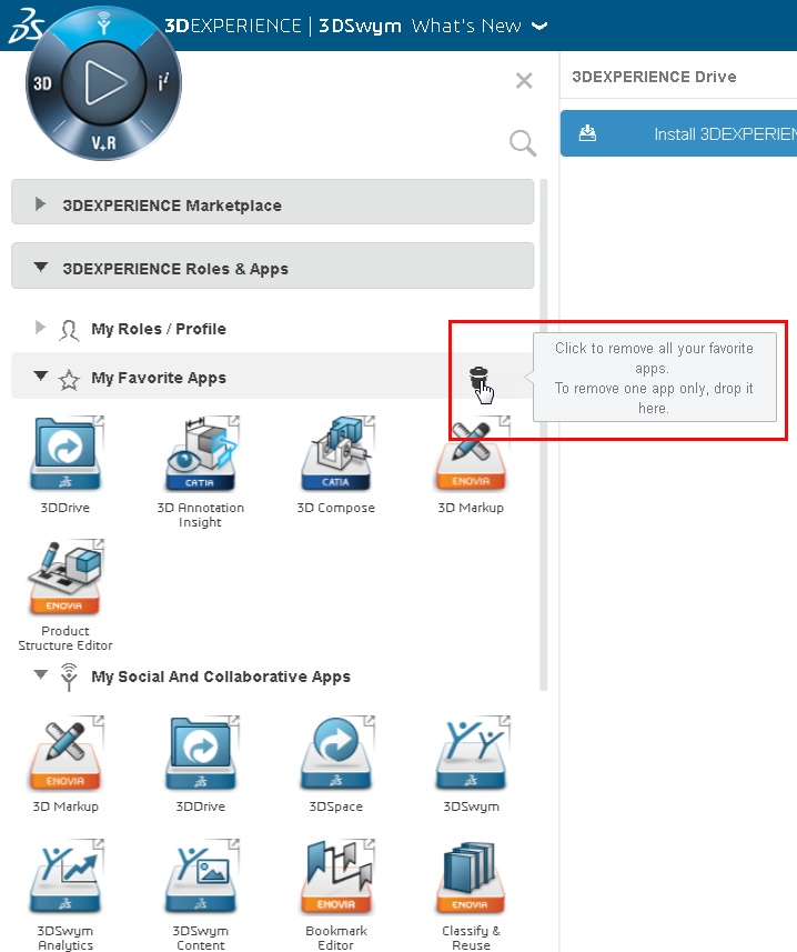

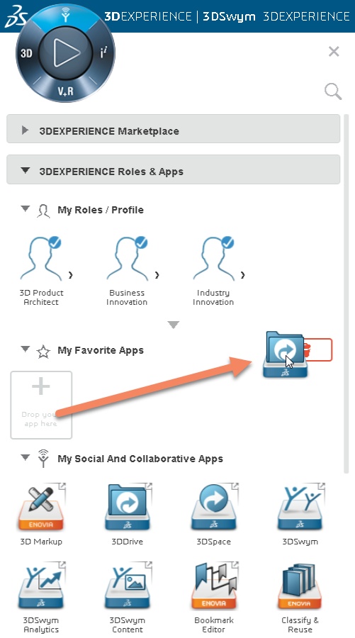

3. Finally, if you want to remove one of your favorite apps from the "My Favorite Apps" section, drag and drop this app on the trash icon,
or remove all your favorite apps by clicking on the trash icon.
Make sure all of your roles are activated. If not, the app you added in the My Favorite Apps might not be displayed (see below).
