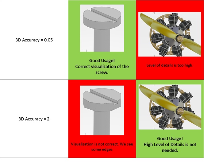

Example :
Accuracy Option allows to find a balance between rendering precision and performance.
In the case of the screw as it is a small part, accuracy have to be low, because we need details.
Prefered option is 3D accuracy set to 0.05. Because with the 3D accuracy set to 2, Tessellation is not optimum as circles look more like polygons.
In the case of the engine plane as it is a bigger assembly, we don’t need a high level of details.
Prefered option is 3D accuracy set to 2. We see no major differences between these 2 pictures, so with the 3D accuracy set to 0.05 the level of details is too high.

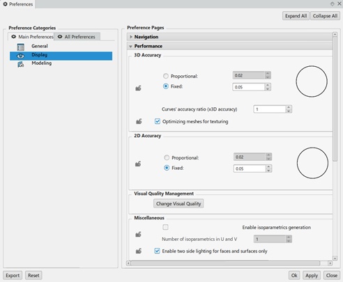

How to change 3D Accuracy ?
1 - From the Me menu select Preferences
2 - Navigate to Main Preferences > Display
3 - Change the value for 3D Accuracy
4 - Select Optimizing meshes for texturing.
