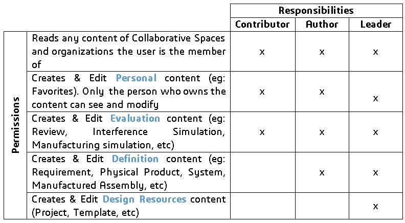

- Regular tasks e.g. Reader, Contributor, Author, Leader, etc
- Administrative tasks e.g. Owner
Here are the permission available with the responsibility “Owner” Reads any content of the assigned collaborative space including personal content
- Creates Administrative/Resources category content (e.g.: Collaborative Spaces, persons, Engineering Template, etc.)
- Manages collaborative space resources such as persons, standard content, etc.
- Modifies design content belonging to the collaborative space for repair or exception tasks. Cannot create Design Content.

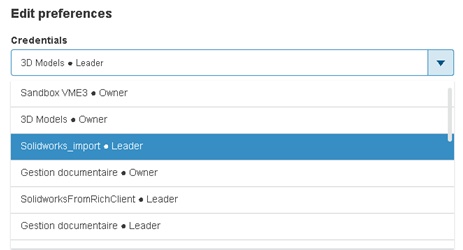

Widget
A widget is an app, which can be placed on a Dashboard tab that allows users to access information or perform actions.
To change the credentials within a widget, you use the “Edit Preferences” to select the right credential (that is consists of Collaborative Space & Responsibility)

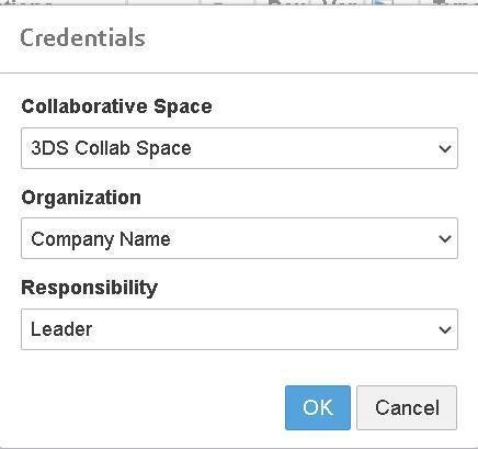

Web app
A web app is an app that opens in a separate web browser tab.
Within a Web app, I can change Organization, Collaborative Space and Responsibility.
To change the credentials within a web app, you use the “Credentials” command to select the following:

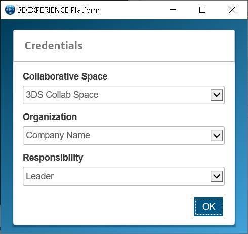

Native App
A Native App is an app that is loaded onto an external application (such as CAD). These native apps require the installation of media locally, for both On Premise and On Cloud.
Within a Native app, you can change the credentials by changing Organization, Collaborative Space and Responsibility.
