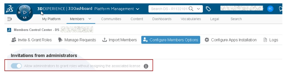

The very first step is to enable following global option on your Platform Management dashboard:
Once this option is enabled, the two Options Assign License and Restrict usage to this Platform are displayed.

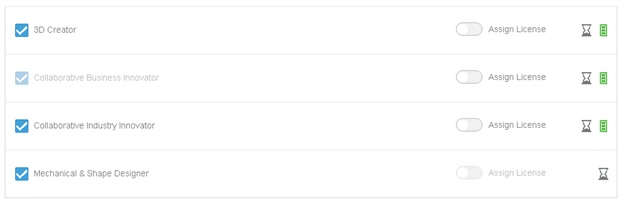

Then you are in position to send invitations in which the granted Roles will have the Assign License option deactivated for the Roles you need to grant to the external user.

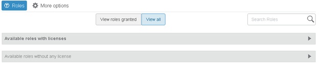

To extend Collaboration, you can add any available Roles either from  Available roles with licenses or from Available roles without any license drop-down list:
This works even if you are already using 100% of your Licenses.
If you forget to deactivate the Assign License option before you send the invitation, the external user might consume your invitation in the next minute and the license keys will be locked for 30 days. So I recommend you to double-check the Roles assignment before completing the invitation.

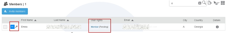

Once the invitation is sent you will see the Pending user with the key icon which identifies users who are in collaboration mode.

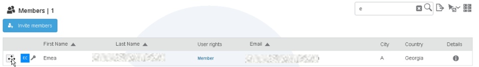

Once the external user will have accepted your invitation, the Pending status disappears and you will see his First Name and Last Name from his 3DEXPERIENCE ID login.

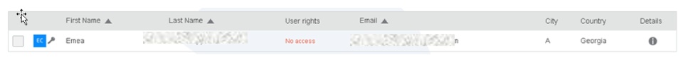

At this stage, you can decide to suspend this collaboration by Removing Access to this user.

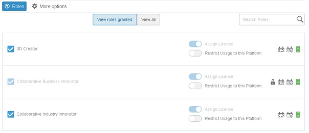

How to set up the 3DEXPERIENCE platform of the external user?
The same global option must be enabled from the Platform Management dashboard:
This option enables to grant Roles with Assign License option activated and Restrict Usage to this platform option deactivated. This is this second option which enables to reuse this license key on any other platform for collaboration.
So the other administrator must ensure that his user has got necessary Roles and Licenses with Assign License option activated and Restrict Usage to this platform option deactivated. as depicted below
