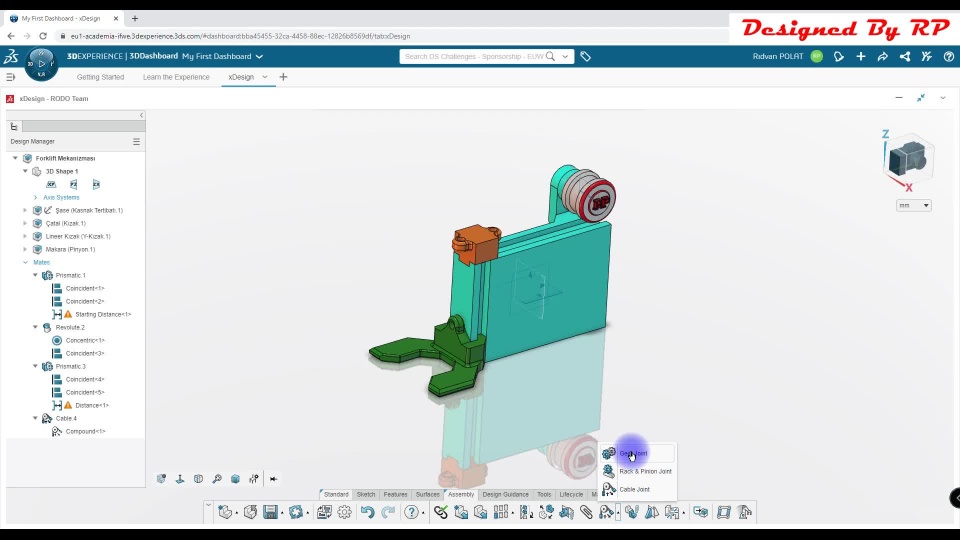

I tried to show how to export a simple forklift mechanism mate in xDesign.
My English is not very good. If there are mistakes in the words, please kindly warned me.

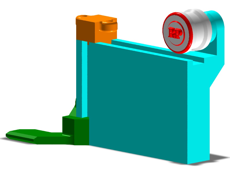

Scenario: The pulley is connected to a motor and the pulley diameter is 7.96 mm. Pulley diameter circumference is 7.96xPi = 25 mm. The linear rail is connected to the pulley with a rope at one end. At the other end, it is connected to the fork with a rope. Linear rail can move maximum 75 mm on the chassis. Likewise, the fork can move a maximum of 75 mm. When the pulley moves 1 full turn, the linear rail will move 25 mm and the fork connected to the linear rail will move 25 mm. When the pulley moves 3 full turns, the linear rail and fork will move 75 mm.
