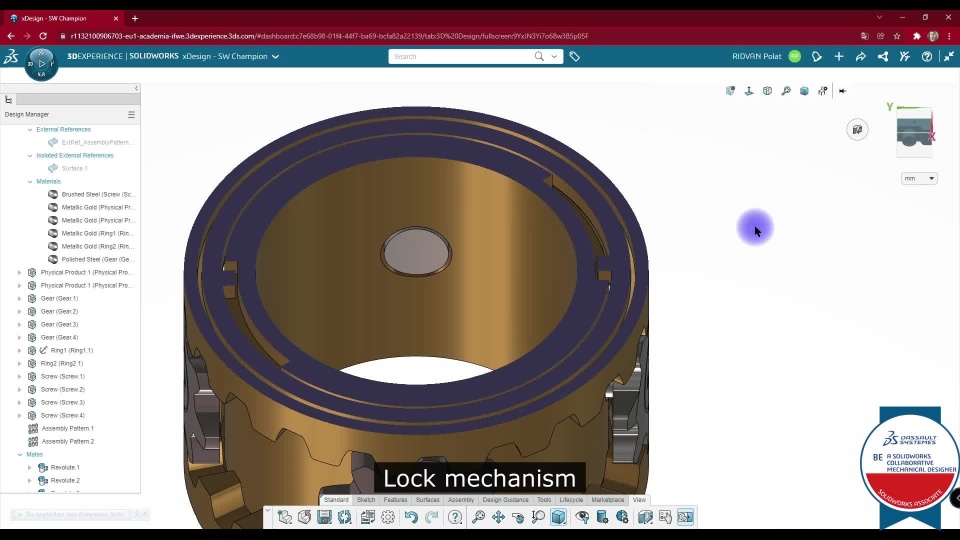

I finished the design of the Gear Ring ring. Although it has a simple structure, I used many commands in xDesign while making this design. That's why I'm going to show you how this design is made for the content that will be the continuation of my "3DEXPERIENCE My Experience with SolidWorks and Cloud Applications" series.
I will make a video series that will show you how to do it with a tablet step by step.
Since I will be producing on a 3D printer, I left working gaps.
I facilitated the movement of the gears by leaving a 0.25 mm working clearance.
The clearance in the locking mechanism is 0.15 mm. I fixed it with a tight fit.
