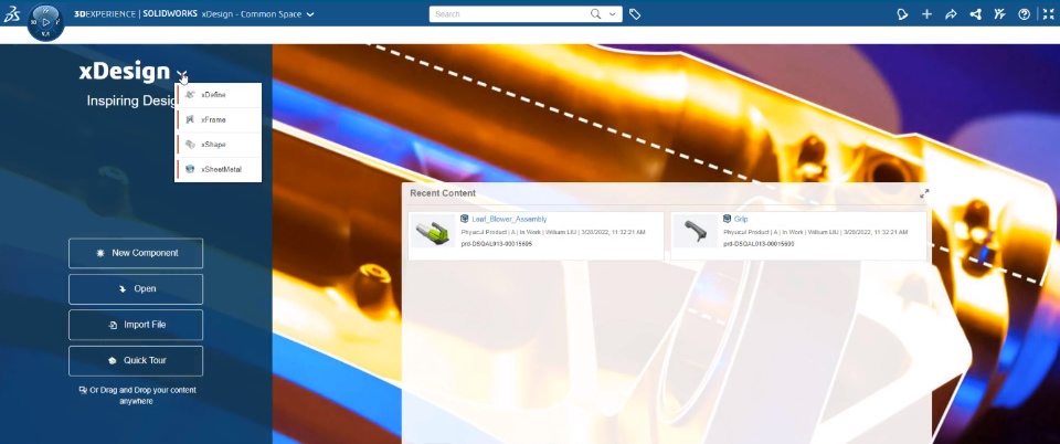

Quick App Switching on Homescreen
Now Quickly Switch between all the xApps available to you, right on the homescreen.
You can use just one dashboard with one widget for all the xApps, and easily switch between them.
