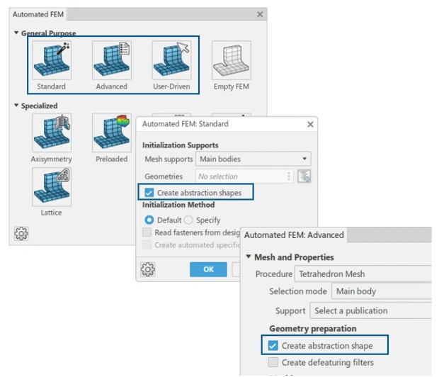

Introduction
An Abstraction Shape on the 3DEXPERIENCE platform is a simulation-only, dependent copy (a representation) of the original CAD geometry that you can modify for meshing or analysis without changing the design (master) CAD. It lets you create simplified/sized/modified geometry for simulation (defeaturing, shrinkwrap, axisymmetric simplifications, cutting away regions, adding simulation-only partitions) while preserving the original part in the product structure and CAD history. This is a native capability of the Simulation Model Preparation / Abstraction Shape workflow in 3DEXPERIENCE.

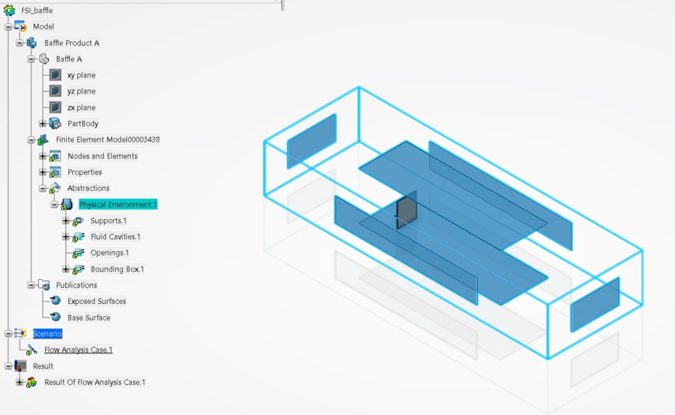

Abstraction shape in Fluid scenario creation app
Why that matters:
Design geometry stays intact (no destructive edits), multiple abstraction shapes can be created from a single design part for different analysis types (e.g., one for static, one for CFD, one for axisymmetric). Tutorials and short demos on the platform demonstrate creating abstraction shapes and using them for axisymmetric / simplified meshing.
