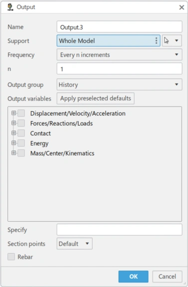

In 3DEXPERIENCE Platform (SIMULIA)
  • The same logic applies, because the Abaqus kernel is used underneath.
  • You can request History Outputs in the scenario definition (just like in Abaqus/CAE step module).
  • After the run, you can use Results Analytics to extract the history data.
  • If scripting: same API (step.historyRegions).
