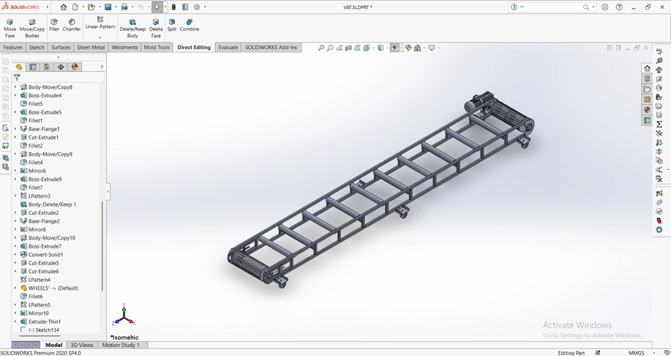

Utilized SolidWorks for the complete design process, employing weldment and sheet metal features for the structure. Conducted SolidWorks simulations (structural analysis, motion study) to evaluate stress, deformation, and conveyor stability before the manufacturing phase.

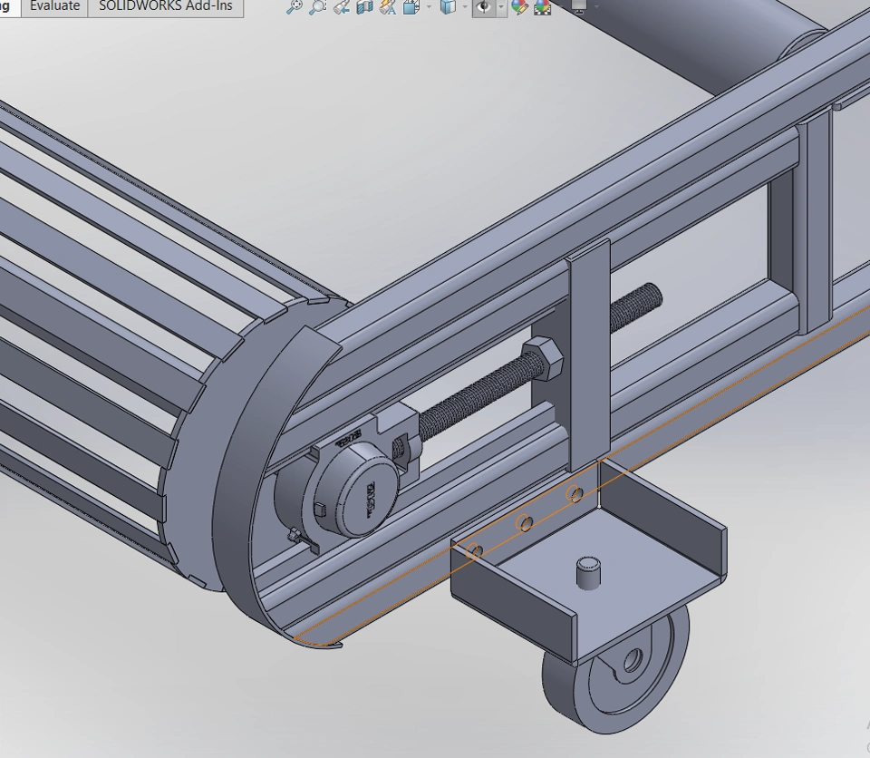

belt tension : I used UCT bearing for the tension
