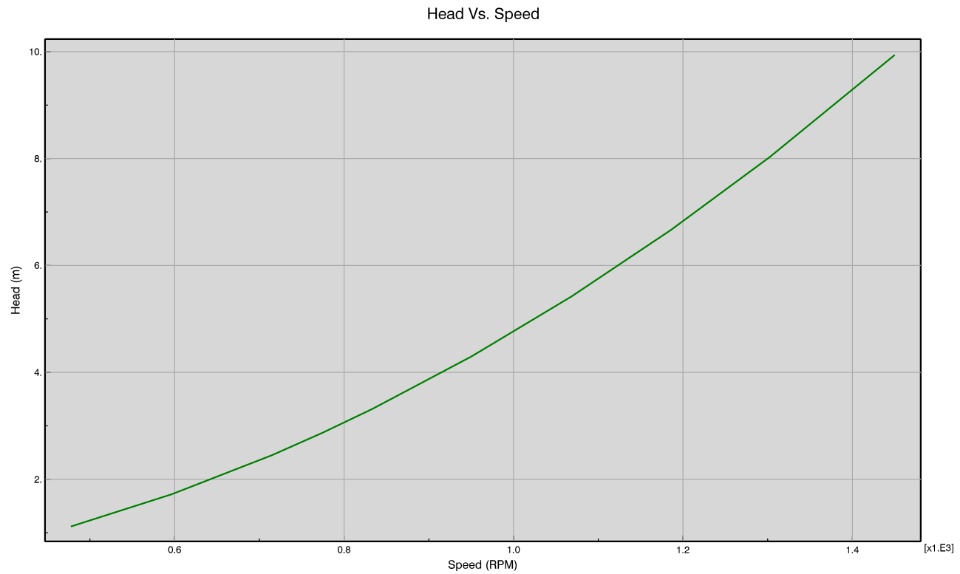

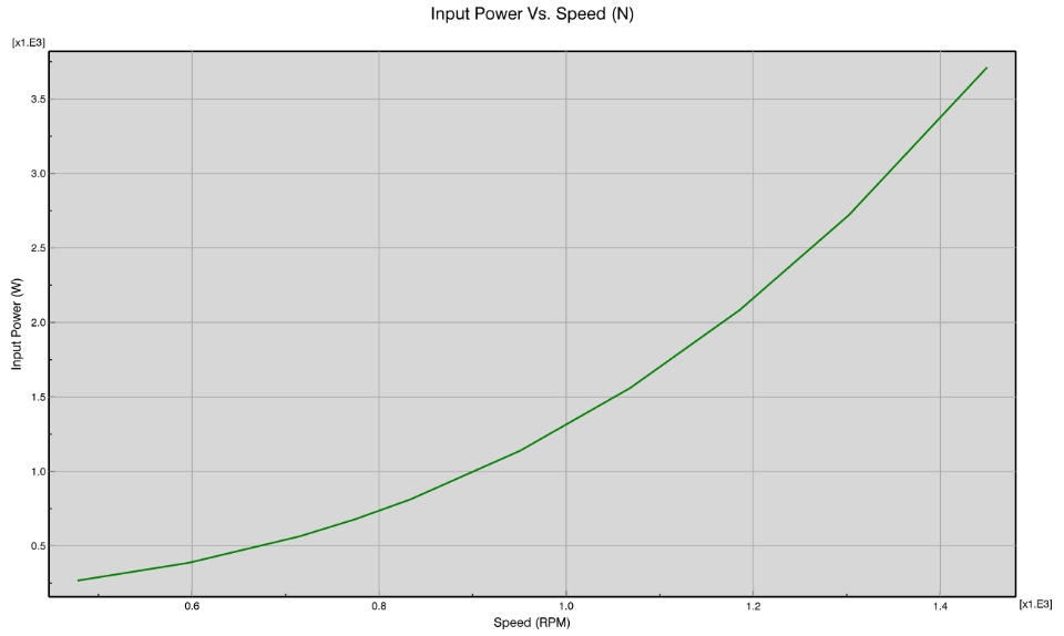

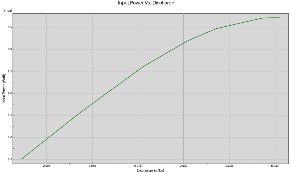

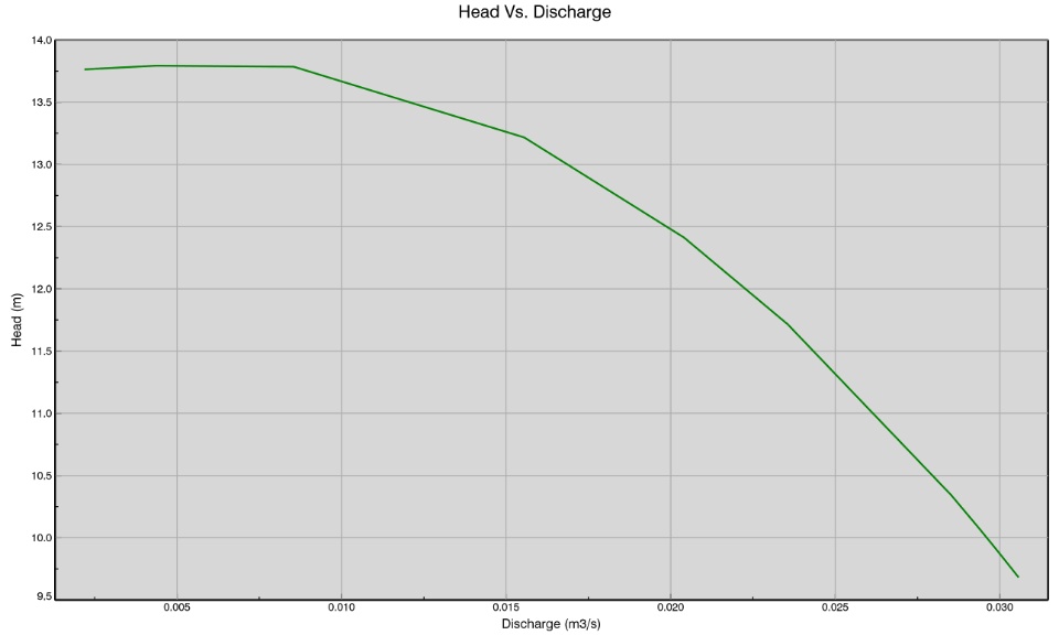

               The pump is usually designed to operate at a particular speed, discharge, and head. But it might happen that the pump is running at some different operating point, that is why it is necessary to conduct tests or trials on a pump to predict its behavior and performance under varying conditions. The results obtained through these tests are called characteristic curves. Characteristic curves are of 2 types: 1) Main Characteristics and 2) Operating Characteristics. Using the virtual lab that we have created; we can carry out both of these trials on the setup and we can plot the required graphs. For example, the following results were obtained from the test that we have carried out on this setup:
Main Characteristics:
Operating Characteristics:

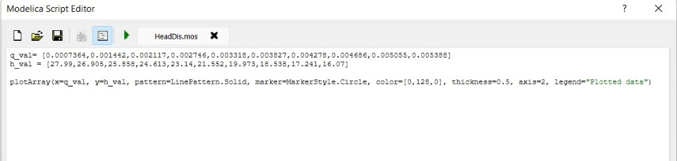

               To plot these graphs, we have used scripting in which we have utilized a function which was there in Dymola Commands. The following image shows one such script.
