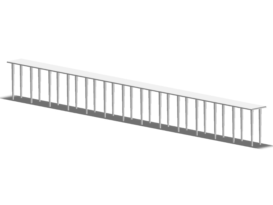

Today I finished the equation training on eduspace. And I immediately wanted to make a design about it. The first thing that came to my mind was the buffet meals :D. And the idea of making a table made sense.​​​​​​​
TekyazInternTeam ​​​​​​​

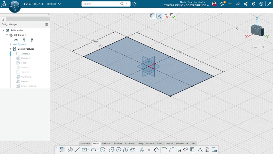

First drawing.​​​​​​​
First, I started by drawing a rectangle.​​​​​​​​​​​​​​

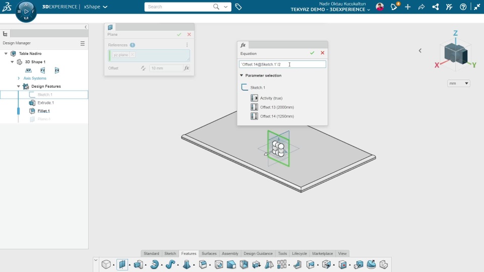

In the second video
I showed how to assign the plane by equation. The reason I did this was to adjust the legs of the table according to the width while giving the width measurement.​​​​​​​

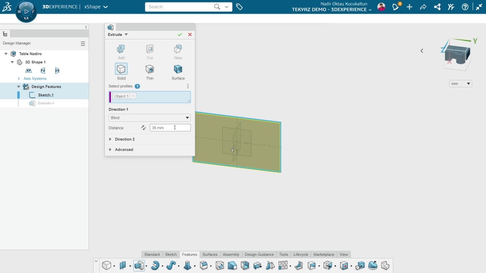

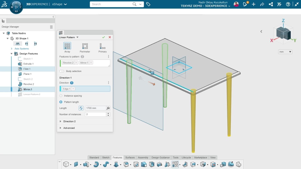

In the third video​​​​​​​
I showed the revolve and mirror commands.

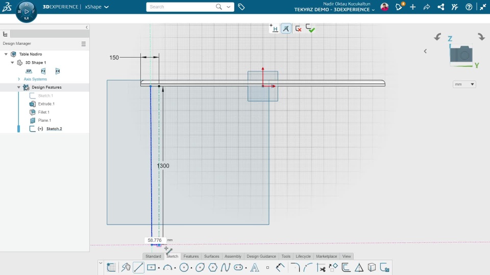

In the fourth video​​​​​​​
This is the most important part. Because here I show how I use equations in design.​​​​​​​
In the last video
Here I have included a video showing how my design with equations works. This is the best part of my videos.​​​​​​​
