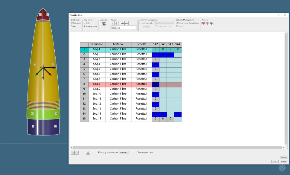

To start, we will generate groups of plies based on the previously created grids. This will allow us to reinforce or create a ply that can be handled more carefully. For instance, we need to place a ply from the sleeve of the nose cone to the tip as a first layer. However, layering the entire section at once will result in lousy control during the layering process. Therefore, we divide this into smaller pieces. With the grids created, we can now define the layer thickness at each grid to create reinforcements where needed. As you can see in the attached photo 1, not every grid has the same amount of plies. For example, grids C4 and C8 have more plies than grids C1 and C5.

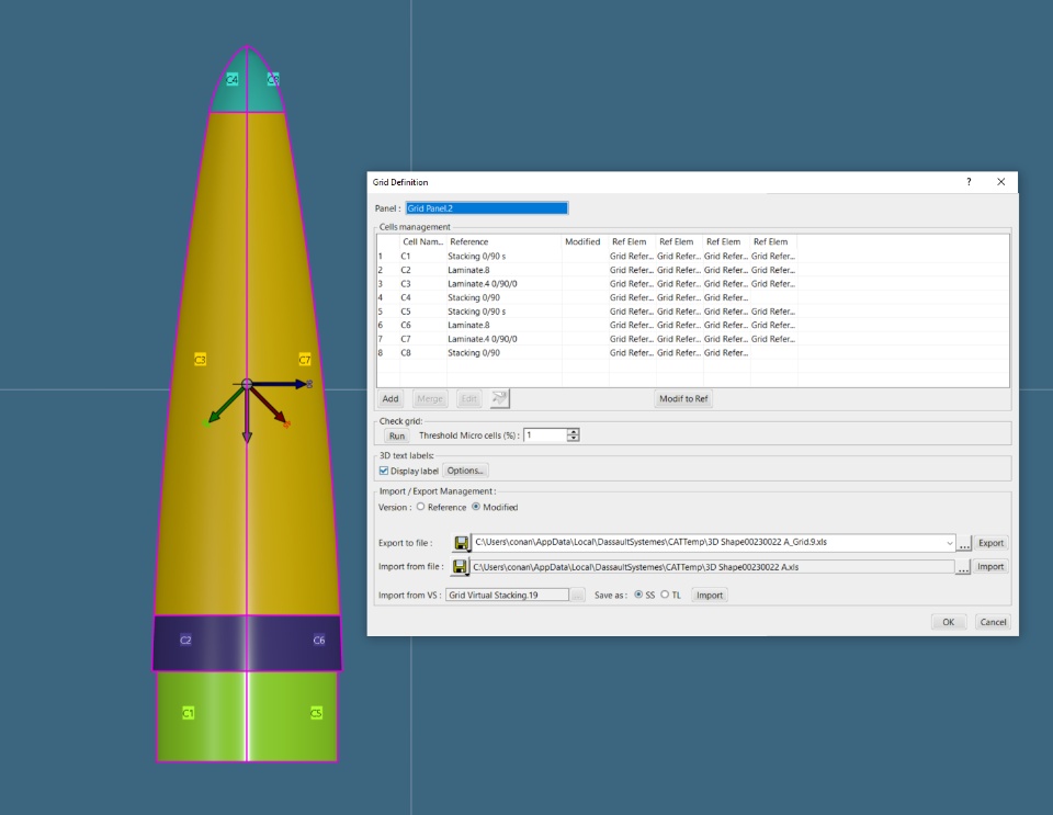

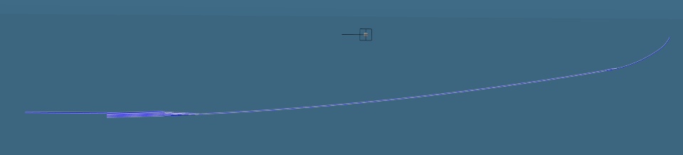

Once we've added the necessary number of plies to the appropriate grids, we can observe how the app arranges the plies for us using ramping. This process entails adding a specific material to each ply to overlap the previous ply. In the second attached photo, you can see the resulting layering, with the first ply being a 0-degree ply that passes through the tip, main body, sleeve build-up, and sleeve. This is not ideal since it provides less control and reduces the chances of getting the tip perfectly. Therefore, we need to change the layering order so that the first ply we lay down is from the tip grid section. The app has considered this design modification, making it easy for users to rearrange the plies' order. The third attached photo shows my result, with the nose cone grid section ply as the initial.

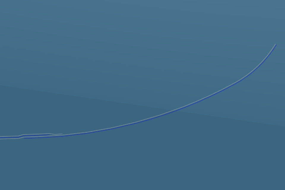

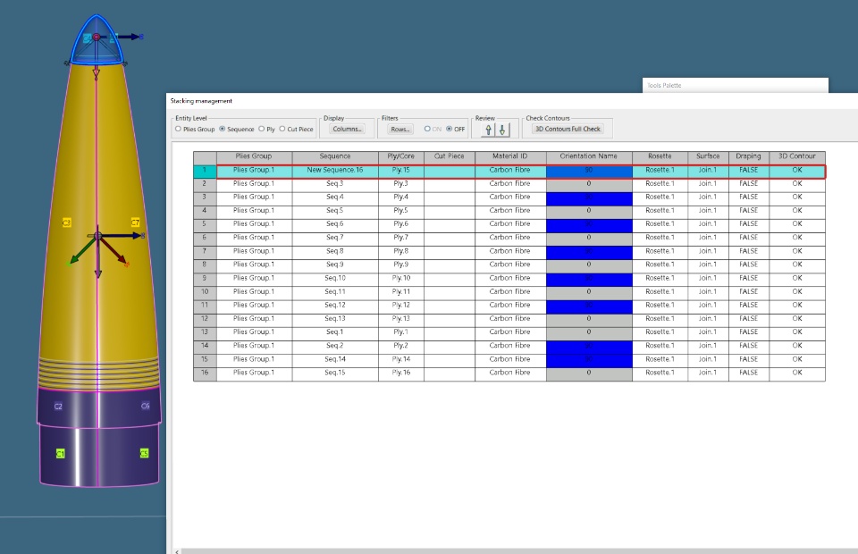

To complete the layering order of the plies, you can create a cross-sectional view of the plies stacked on top of each other using the app. You can preview this view in pictures four, five, and six. Picture number five shows a zoomed-in cross-sectional view of the sleeve ramp-up, where you can see the ramping that was defined beforehand. In picture six, you can see that the first ply at the nose cone grid section is separate. This cross-sectional view also serves as a validation tool to ensure you are satisfied with the layering result.
