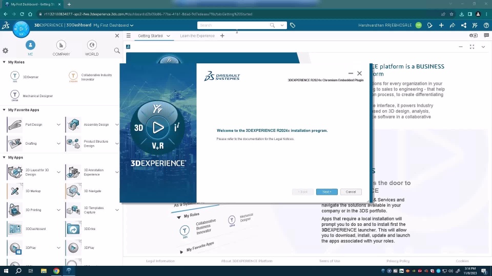

The Installation sequence will be:
1. Install Launcher
2. Install "Chromium Embedded Framework (CEF)" component
3. Install Native Apps
For Individual users:
​​​Installation of CEF is available by clicking on compass and app, and installed as mandatory component at first use (and later when update is available).

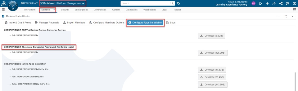

For Platform Administrators, bulk installation or script based installation:
CEF installer media will be displayed in Platform Management in the "Configure Apps Installation" Tab.
This media can be downloaded and used for installation as needed. Keep watching the community for "Sample Script".
