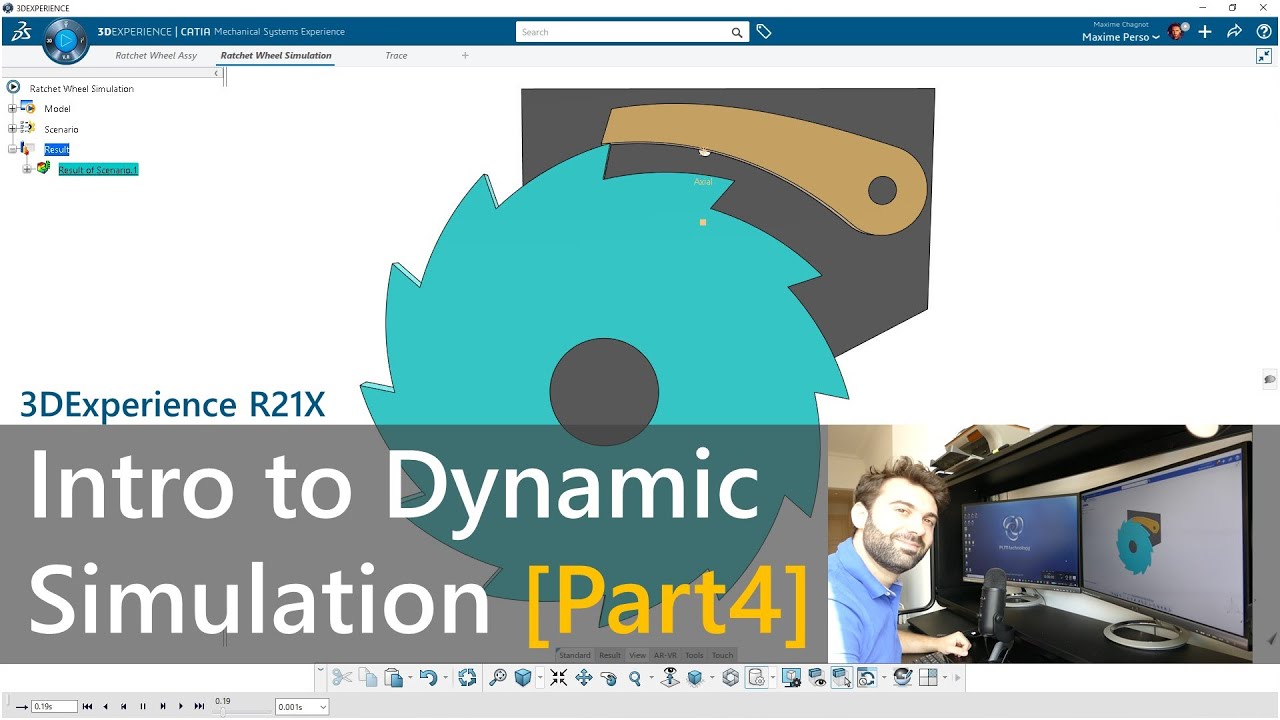

In this fourth part of the tutorial series on Dynamic Simulation on CATIA 3DEXPERIENCE, Maxim Chagnot explains the concept of Axial Spring in Mechanism Systems Experience. He uses the example of a Ratchet Wheel and a pawl to illustrate the importance of the spring. The tutorial covers the creation of engineering connections, contacts, and a spring, followed by the creation of a Dynamic scenario using a motor excitation on the Ratchet Wheel to study the motion of the Pawl. Finally, he demonstrates how to extract the traces of the pawl and replace the motor with a position motor to rotate the wheel in both directions. This video will be helpful for anyone interested in learning more about 3DEXPERIENCE.
