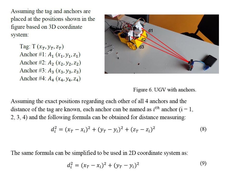

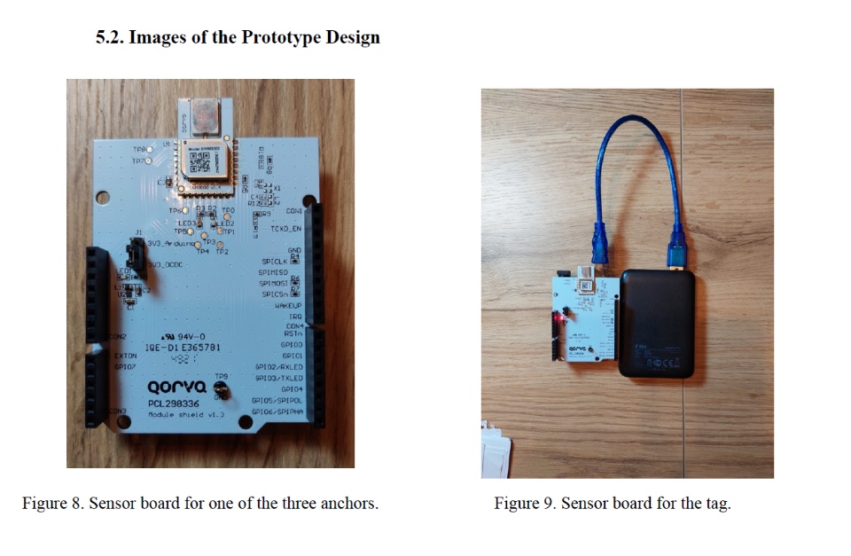

We created the distance-based tracking algorithm of our robot together with calculations on paper. According to this algorithm, our robot will calculate 3 different distances using the x, y and z coordinates of the 3 anchors it has and the tag on the person it will follow.The reason why we use 3 different Anchors and 3 different distances is to with position the Sensors in front, right and left of the robot . İts can rotate 3 different directions and follw the target.Our robot will calculate the point at the intersection of the 3 with 3 different distances, 1 meter apart. The reason why the distance is 1 meter is to keep the distance of security basically. In other words, if our robot is 1 meter away from the target, it will follow it and if the distance is less than 1 meter, it will stop directly to avoid hitting it. If we take into account the delays, 1 meter will be enough for us.
Our algorithm, in which we use a total of 4 Uwb Sensors, consisting of 3 anchors and 1 Tag, basically works like this.
Our next goal will be to code the algorithm on the paper we created.
