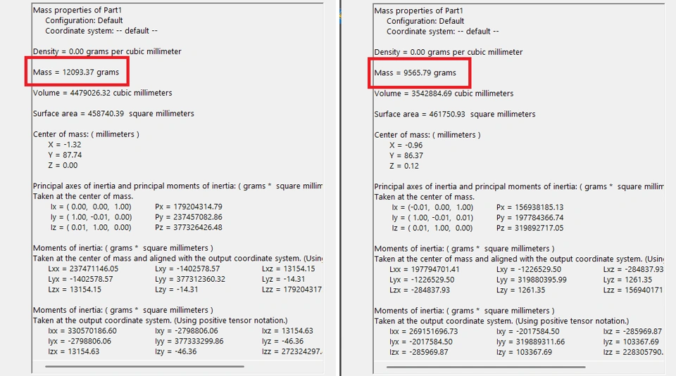

Original Mass: 12.093 kg (12,093.37 grams)
Optimized Mass: 9.566 kg (9,565.79 grams)
Mass Reduction: 21%

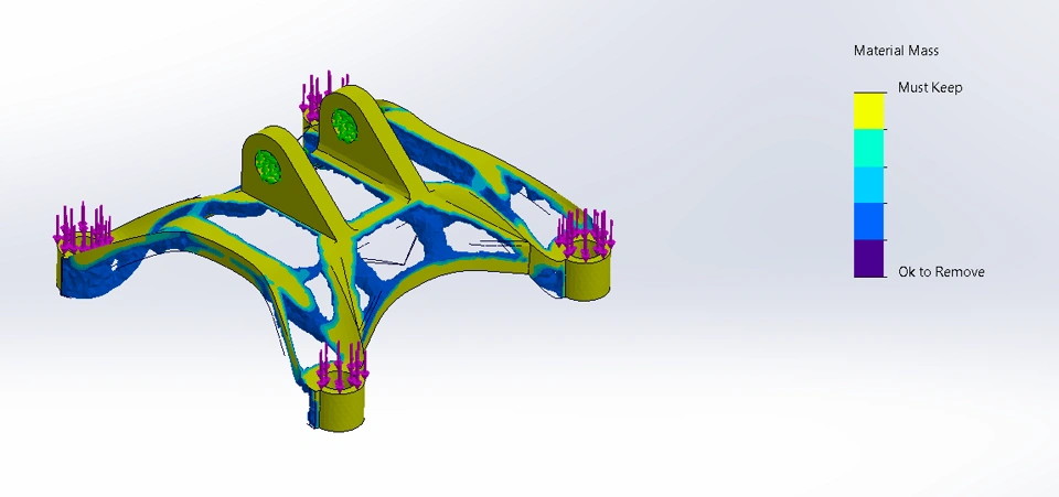

The optimization process identified regions where material could be safely removed without compromising the integrity of the structure. Using SOLIDWORKS Simulation, the final design retained the necessary material in high-stress areas (highlighted in yellow), while the optimized sections (highlighted in blue) were minimized.

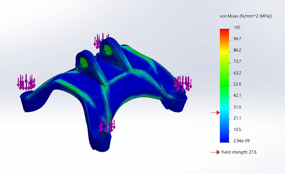

9. Review the Results
  • Once the simulation completes, view the results:
    • Use Displacement, Stress, and Mass plots to analyze the optimized shape.
    • Interpret the topology optimization results for further design refinement.
The topology optimization results highlight:
🔹 Blue Regions: Material that can be removed
🔸 Yellow Regions: Critical areas that must be kept

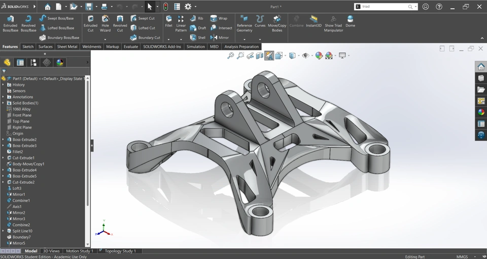

Bracket part model

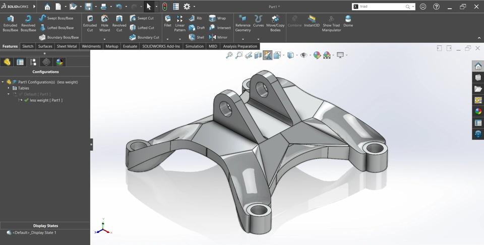

Optimized part model
Final Results:
The final design achieves a 21% mass reduction, enhancing material efficiency while maintaining structural integrity. This is crucial for industries like aerospace, automotive, and robotics, where reducing weight without sacrificing strength is essential for performance and fuel efficiency. The optimization also benefits 3D printing by using less material, resulting in faster production times and less waste. Additionally, it promotes sustainability by reducing material usage and environmental impact, aligning with the growing emphasis on eco-friendly practices in engineering.
