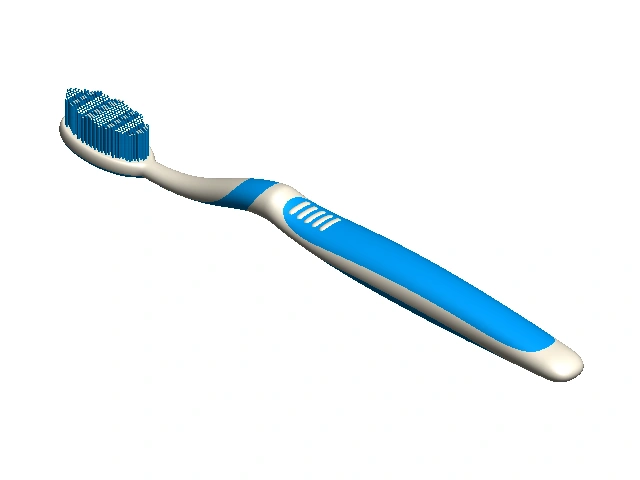

  I would like to showcase the skills, hints and the results of the self challenge that i took on.
Mastering the fundamentals of SolidWorks surfacing is absolutely essential to create a complex, ergonomic design like a toothbrush that i have choose to show up. Here's why basic surfacing knowledge forms the foundation for such advanced designs:

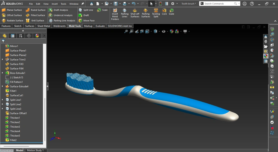

  • Trimming basics allow designers to cut surfaces precisely (as seen in Surface Trim1/2)
  • Filling gaps (Surface Fill1) requires understanding of boundary conditions
  • Extending/offsetting surfaces helps when adjusting proportions or adding thickness
3. Transition to Solids
  • Knitting surfaces must be mastered before converting to solids (58 solid bodies in this design)
  • Thickening operations require proper surface preparation to avoid failures
  • Understanding surface normals prevents inverted geometry issues
4. Problem-Solving Foundation
  • Diagnosing surface errors (gaps, overlaps, twists) relies on fundamental knowledge
  • Repair techniques build upon basic surfacing commands
  • Rebuilding strategies when design changes are needed
5. Design Intent Implementation
  • Parametric relationships between surfaces stem from basic modeling principles
  • Reference geometry usage (planes, axes) shown in the design tree builds on fundamentals
  • Feature order understanding affects rebuild time and flexibility
Without these surfacing basics, the complex transitions (multiple lofts), ergonomic contours, and precise trims visible in the toothbrush design would be impossible to create reliably.
The advanced features shown in this example (Surface Loft1-3, Surface Sweep1, etc.) all depend on fundamental surfacing competencies to execute properly and make subsequent modifications possible.
