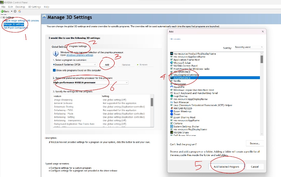

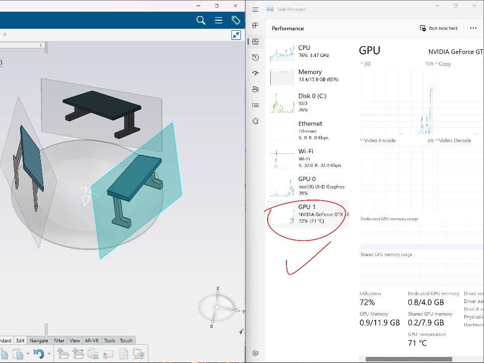

Hello everyone, I'd like to give a tip on how to improve frame rate and visual performance for 3DExperience. If your frame rate is low, go to the Task Manager in Windows and check if your laptop's external graphics card is used. If it is not and only the integrated graphics is utilized, then it will be slow. For higher performance, you must ensure that the external card is always used whenever 3DX is running.
For those with the Nvidia graphics cards, open Nvidia Control Panel and follow the numbered steps (step 6 can also be : use global setting (autoselect:Nvidia GPU))
ALSO: Disable BATTERY SAVER as this setting will turn off your external GPU
