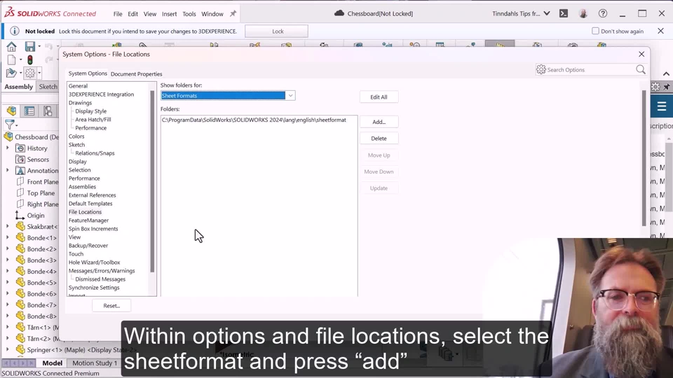

If you work with SOLIDWORKS on the platform, it can be very helpful to place your systemfiles (Sheetformat, Weldment profiles etc) on the platform. Allowing you to access it from any machine you logon to.
