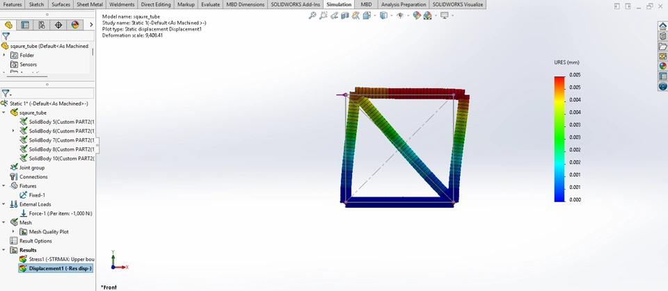

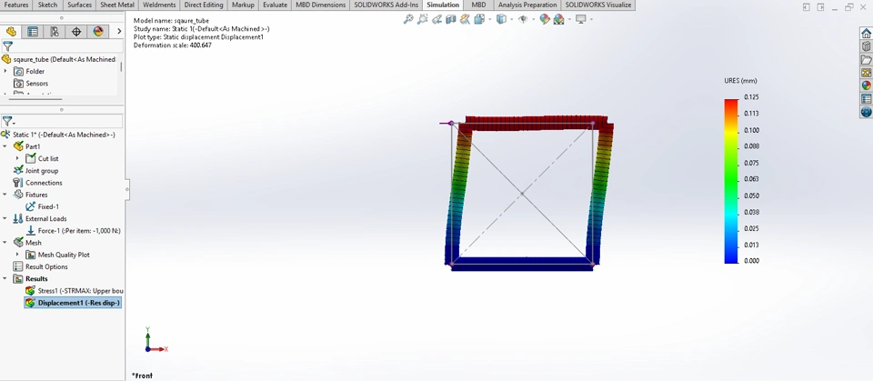

this both without diagonal member .
notice how much Max stress decreased .
and notice how much displacement decreased .

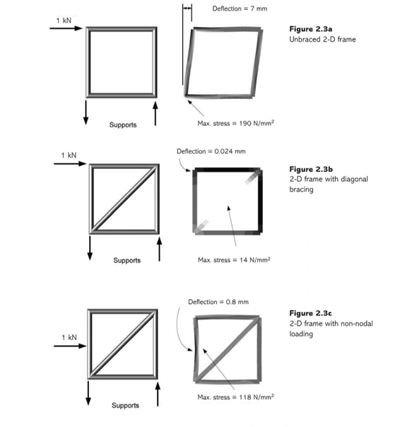

this book called (Race car design by derek-seward) .
