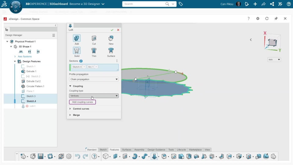

I had planned a bottle cap drawing. I was thinking that I could create drawings with different geometries and achieve this with Loft. However, as a result of my research and experimentation, I learned that it is difficult to do this in xDesign. (Loft solidification of geometries that do not have an equal number of points is not supported by the system. For example, a rectangle-triangle-circle union requires an equal number of points on each.)

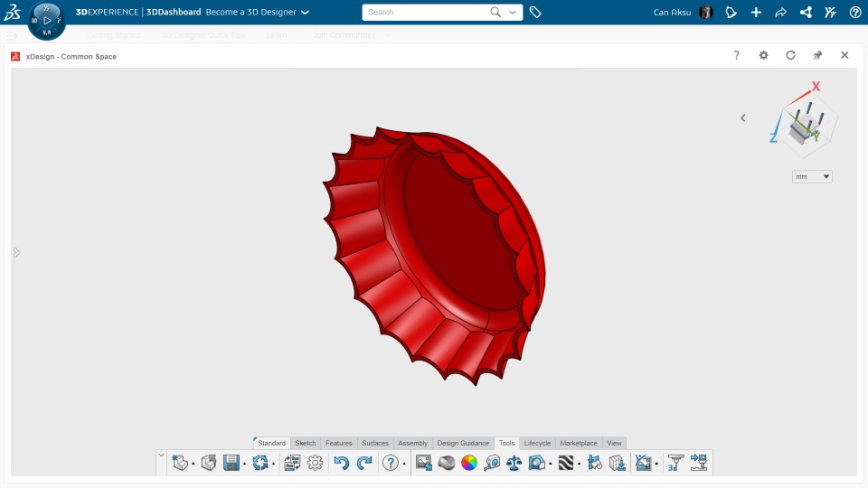

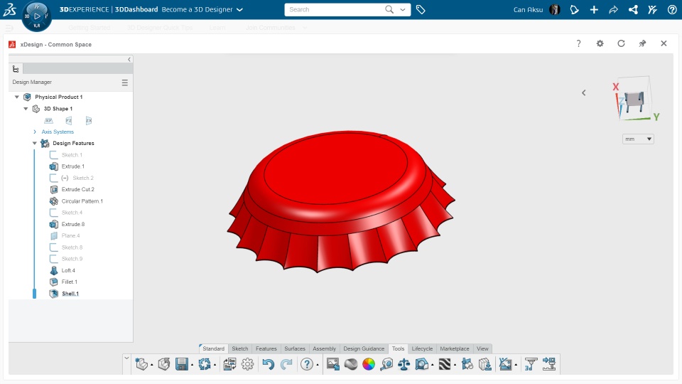

Although I found an alternative by extruding the geometry I made as a base with draft, I could not figure out how to solidify the circle above and the geometry below with loft.
I'm publishing my issue when trying to do Loft. Maybe, you will find a solution and draw a better one. Let's all try.
