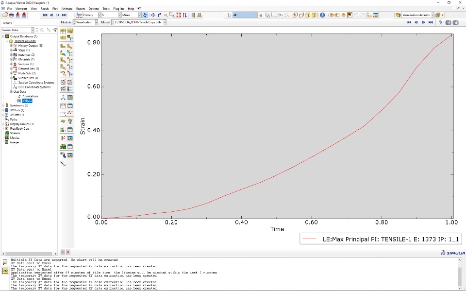

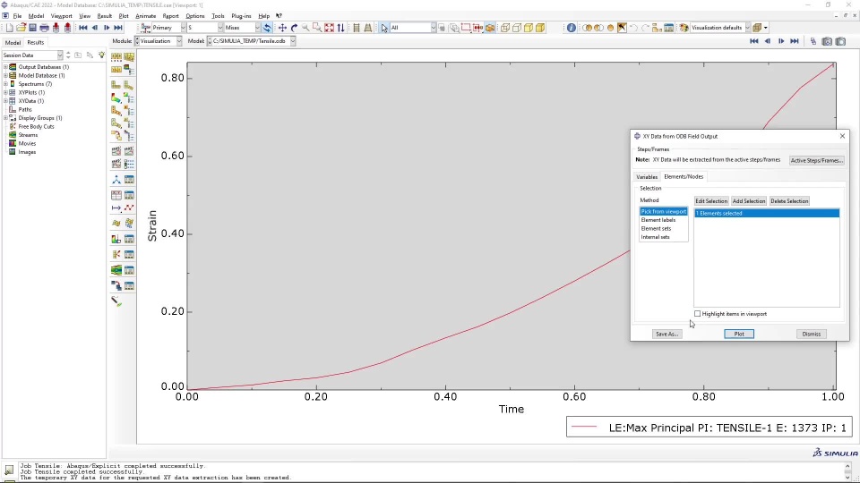

After exporting the logarithmic strain values ​​with Excel with ABAQUS Tools, I tried to calculate the True Strain Rate using these data and create its graph. While doing this, I used Python and its libraries.

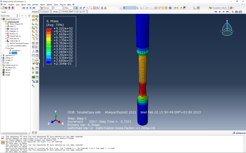

To calculate true strain rate for a tensile test, you will need strain values at different deformation stages. These strain values should be taken from the same location on the part, typically from a small region of interest or a gauge section. The region should be representative of the overall deformation behavior of the material. Therefore, you need to export the strain values from the same point or region of the part at different deformation stages to calculate true strain rate.
