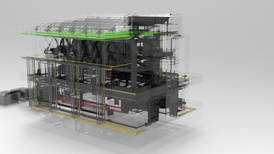

1: House Layout design
i.	Farm animals on the 1st-floor.
ii.	Living arrangement on 2nd-floor.
iii.	2nd floor can be copied according to the demand.
iv.	3rd floor is for wind energy generation and additional living.
v.	r. 4th floor/roof is for solar energy generation.

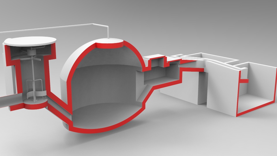

2: Bio-fuel Plant
i.	Situated outside the.
ii.	Dungs of cows are channeled through pipes.
iii.Greywater and human stool get mixed in a mixing chamber.
iv.	Mixing can be done both manually and automatically using electric motor.
v.	Gate opens to transfer samples to decomposition chamber.
vi.	Samples get fermented here.
vii.Gas is generated and gets trapped in the upper side of the dome.
viii.Stored gas can be transferred to the kitchen and use as fuel via a supply pipe.
ix.	Remaining’s gets to slurry pit through hydraulic chamber.
x.	Good quality fertilizer can be collected from here after a period of time.
xi.	4m3 of bio-gas can be produced by which 3 families will be able to get 4 hours of cooking time using a standard gas stove.
