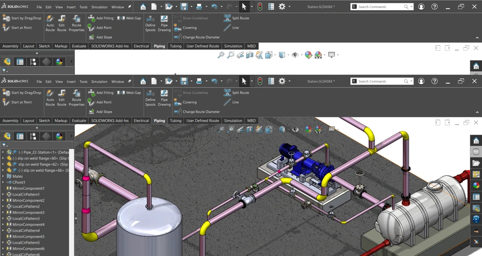

1. Setting Up Your Project
  • Before you start, you need to define the scope of your project. Are you designing a piping system for a factory, a tubing system for a hydraulic machine, or an electrical harness for a vehicle?
  • SolidWorks provides templates and libraries tailored to each type of system, so you don’t have to start from scratch.

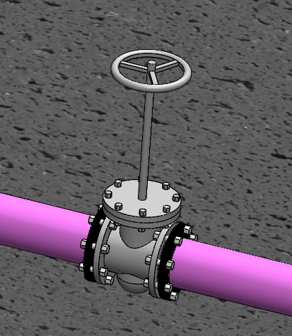

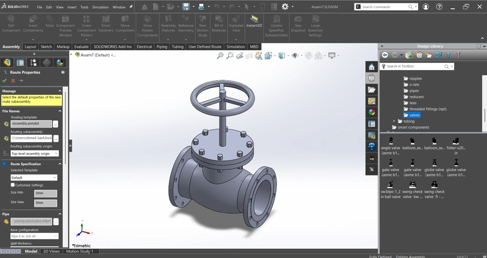

2. Using Component Libraries🔩 ⚙️
  • Think of this as your toolbox. SolidWorks comes with prebuilt libraries of standard components like pipes, elbows, valves, connectors, and more. These libraries are based on industry standards (e.g., ASME, DIN, ISO).
  • For example, if you’re designing a piping system, you can drag and drop a 90-degree elbow or a gate valve directly into your assembly. No need to model these parts manually!
  • You can also create custom components and add them to your library for future use. This is especially useful if you’re working with proprietary or non-standard parts.

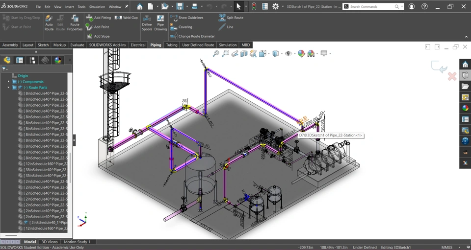

3. Creating the Route
  • This is where the magic happens! You start by defining the start and end points of your route. For example, you might start at a pump and route the pipe to a tank.
  • SolidWorks uses 3D sketching to define the path of your route. You can sketch lines, arcs, and splines in 3D space, and the software will automatically add fittings (like elbows or tees) at bends and intersections.
  • If you’re not sure how to route the system, SolidWorks can auto-route for you based on the components you’ve placed. It’s like having a GPS for your pipes or cables!
4. Editing and Optimizing
  • Once the route is created, you can easily modify it. Need to move a pipe or change the diameter? No problem! SolidWorks updates the entire system dynamically, including all connected fittings.
  • Use interference detection to check for clashes between components. This ensures your design is feasible and avoids costly mistakes during manufacturing or installation.

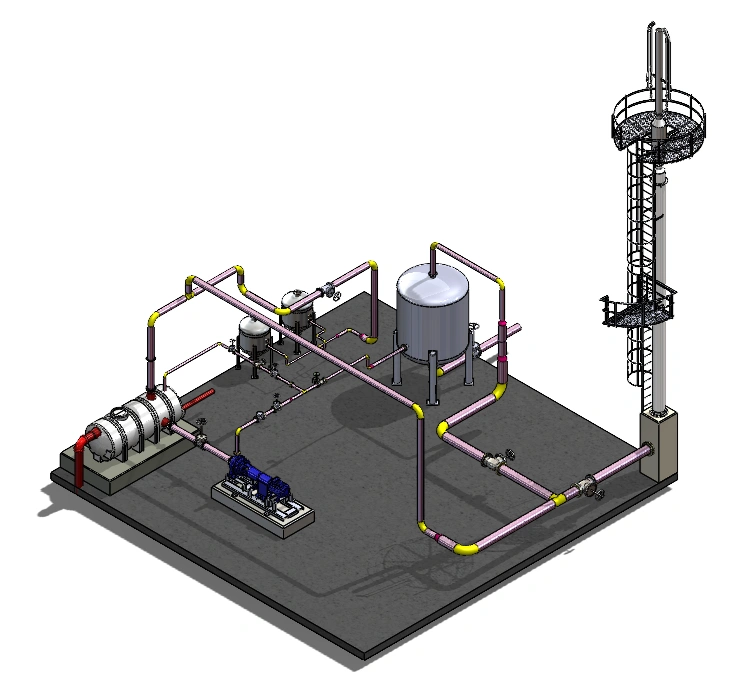

Real-World Applications
Let’s look at some examples to see how SolidWorks Piping and Routing can be used in different industries:
  1. Oil and Gas:
    • Design complex piping systems for refineries or offshore platforms.
    • Ensure compliance with safety standards and optimize the layout for efficiency.

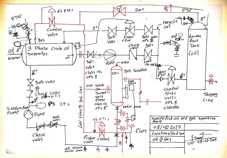

Pipeline Fundamentals
  1. Pipe Class: Defines the pressure rating and material of the pipe. Common classes include 150, 300, 600, etc.
  2. Schedule: Refers to the wall thickness of the pipe. Common schedules are SCH 40, SCH 80, SCH 160. Higher schedules mean thicker walls and higher pressure handling.
  3. Valves: Control the flow of fluids. Common types include gate valves, ball valves, and check valves.
  4. Flanges: Connect pipes, valves, and equipment. They come in types like weld neck, slip-on, and blind flanges.
  5. NPS (Nominal Pipe Size): A North American standard for pipe diameter.
    DN (Diameter Nominal): The metric equivalent.
  6. Standards: Pipelines follow strict standards like ASME B31.4 (liquid pipelines) and ASME B31.8 (gas pipelines).
  7. API (American Petroleum Institute): Provides guidelines for design, materials, and testing (e.g., API 5L for pipeline steel).
