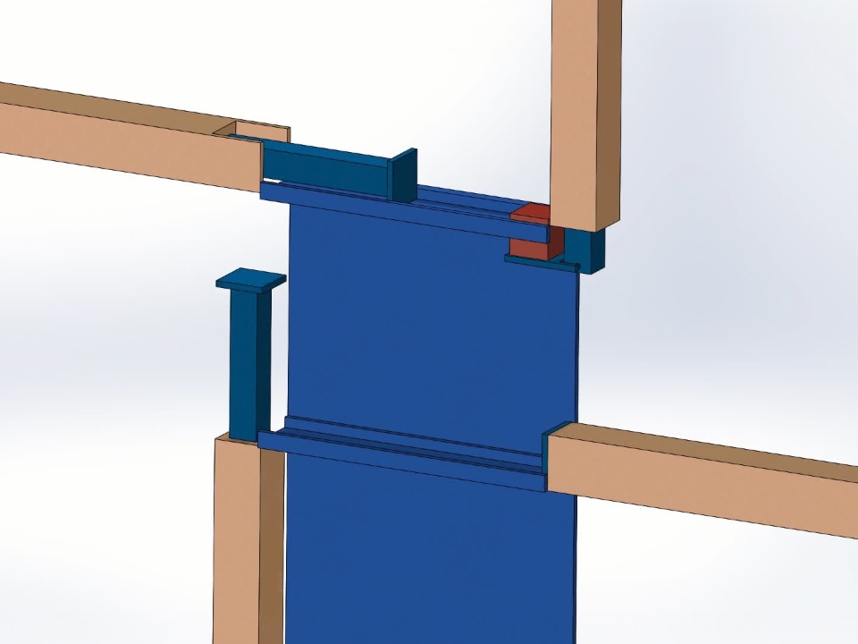

This SOLID Saturday we have the Event-Based Motion analysis in SOLIDWORKS. Event-Based Motion Analysis requires set of tasks. Tasks can be sequential or overlap in time. Each task is defined by a triggering event and its associated task action. Task actions control or define motion during the task.

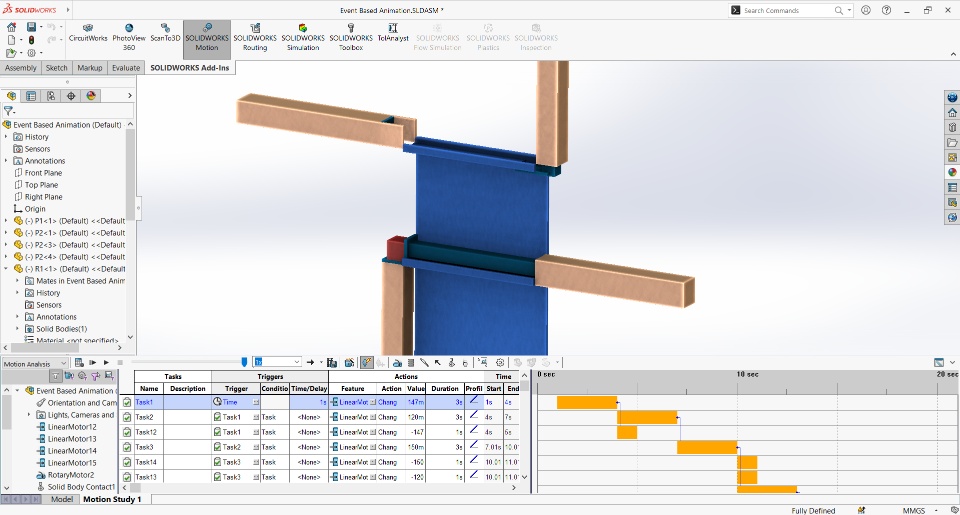

To set up Event-Based Motion Study:
  • From a motion study, select Motion Analysis.
  • Plan out the tasks required to model the event-triggered motion The main components of tasks are time or event-based triggers that define the start of a motion task, and control actions that are implemented as a result of the task trigger. Task triggers include: Task control actions include:
    • Sensors with an Alert condition
    • Time events
    • Previous tasks
    • Applying or changing motors or forces
    • Toggling mates
    • Stopping the motion
  • Create the sensors necessary for triggering motion actions.
  • Set up the constant speed motors or constant forces necessary to define event-triggered actions.
  • Click Event-based Motion View .
  • Create a sequence of tasks.
  • Calculate the motion to test the model.
