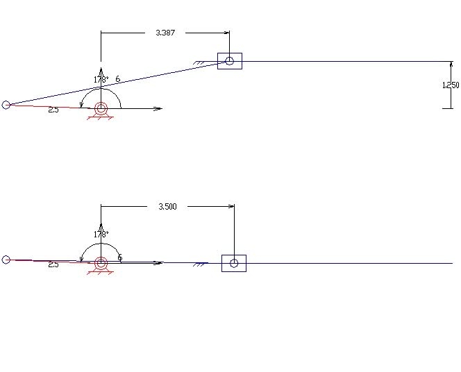

The slider-crank mechanism is made up of three main parts: a crank, a connecting rod, and a slider. A motor or other power source turns a rotating shaft known as the crank. The slider and crank are connected by a straight rod called a connecting rod. The slider is a back-and-forth sliding element that moves in a single direction. The connecting rod and slider are driven through a series of pivot points as the crank rotates, causing the slider to oscillate back and forth. By adjusting the length of the connecting rod, the rotational speed of the crank, or the locations of the pivot points, the slider's speed and range of motion can be altered.
Slider-Crank Mechanism Theory
The concepts of kinematics—the study of motion without taking into account the forces that create it—are the foundation of the theory underlying the slider-crank mechanism. Kinematic equations that link the location, velocity, and acceleration of the connecting rod and crank in a slider-crank mechanism describe how they move in motion. These equations can be used to forecast how the slider-crank mechanism would behave in various situations and are typically calculated using the principles of geometry and trigonometry.
The slider's position can be described using the crank angle, which is the angle between the crank and a reference line. The velocity and acceleration of the slider can be calculated by differentiating the position equation concerning time. In addition to the kinematic equations, the slider-crank mechanism can also be analyzed using dynamics principles, which study the motion and the forces that cause it. This includes the analysis of the forces acting on the components of the mechanism and the torque required to drive the crank.

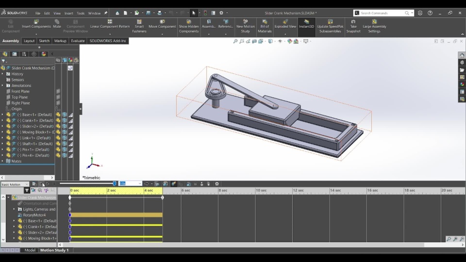

Slider-Crank Mechanism in SOLIDWORKS

Steps to create in SOLIDWORKS
To create a slider-crank mechanism in SOLIDWORKS using the top-down approach assembly method, you can follow these steps:
1. Start a new assembly: Open SOLIDWORKS and create a new assembly document.
2. Create a new part: Create a new part document within the assembly by selecting "File" > "New" > "Part".
3. Sketch the crankshaft: In the new part document, create a sketch on the front plane and sketch the profile of the crankshaft. Define the necessary dimensions and constraints to fully constrain the sketch.
4. Extrude the crankshaft: Use the "Extrude" feature to extrude the sketch profile in the desired direction to create the crankshaft. Define the extrusion depth or distance as per your requirements.
5. Insert the crankshaft part: In the assembly document, select "Insert" > "Existing Part" and insert the crankshaft part you created earlier. Position and orient the crankshaft along the desired axis.
6. Create a new part for the connecting rod: Repeat steps 2 and 3 to create a new part document for the connecting rod.
7. Sketch the connecting rod: In the connecting rod part document, create a sketch on the front plane and sketch the profile of the connecting rod. Define the necessary dimensions and constraints to fully constrain the sketch.
8. Extrude the connecting rod: Use the "Extrude" feature to extrude the sketch profile in the desired direction to create the connecting rod. Define the extrusion depth or distance as per your requirements.
9. Insert the connecting rod part: In the assembly document, select "Insert" > "Existing Part" and insert the connecting rod part you created earlier. Position and orient the connecting rod along the desired axis.
10. Create assembly constraints: Use assembly constraints to connect the crankshaft and connecting rod. Select the appropriate constraint types, such as mate, coincident, concentric, or distance, depending on the desired behavior of the slider-crank mechanism.
11. Insert the slider part: Repeat steps 2 and 3 to create a new part document for the slider.
12. Sketch the slider: In the slider part of the document, create a sketch on the front plane and sketch the profile of the slider. Define the necessary dimensions and constraints to fully constrain the sketch.
13. Extrude the slider: Use the "Extrude" feature to extrude the sketch profile in the desired direction to create the slider. Define the extrusion depth or distance as per your requirements.
14. Insert the slider part: In the assembly document, select "Insert" > "Existing Part" and insert the slider part you created earlier. Position and orient the slider along the desired axis.
15. Create assembly constraints: Use assembly constraints to connect the connecting rod and slider. Select the appropriate constraint types to define the sliding motion between the two components.
16. Test the mechanism: Move the crankshaft component to see the motion of the slider-crank mechanism. Make adjustments to the constraints or dimensions as needed to achieve the desired behavior.
17. Finalize the assembly: Once you are satisfied with the mechanism's behavior, save the assembly and make any necessary additional adjustments or improvements.
