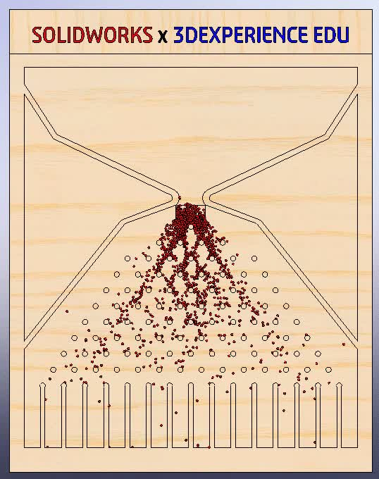

I recently designed and simulated a Galton Board using SOLIDWORKS Motion Study to replicate how random motion results in a normal distribution—a key concept in statistics and probability.
📌 What’s a Galton Board?
It’s a mechanical model that demonstrates the Central Limit Theorem. As balls drop through an array of staggered pegs, they bounce in random directions and accumulate in bins below, forming a bell-shaped curve.
🛠️ Technical Workflow:
  • Modeled the full assembly in SOLIDWORKS: ~3000 individual balls
  • Used Motion Study to simulate dynamic behavior
  • Applied gravity, defined contact sets between balls, pegs, and bins
  • Assigned appropriate material properties (rigid plastic) to control bounce and interaction
  • Leveraged event-based motion for accurate stepwise movement

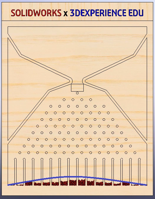

📈 Results:
Despite random bouncing, the simulation converged to a Gaussian distribution—beautifully validating the physics and math behind the system.

🖼️  image of the normal distribution result:
