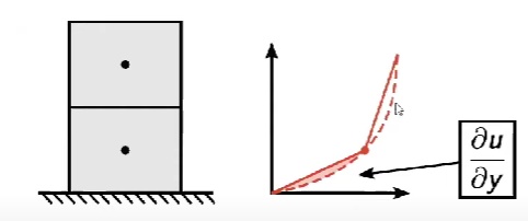

We know, almost in all CFD codes the fluid parameters store at center of the cell and they vary linearly between two cells.

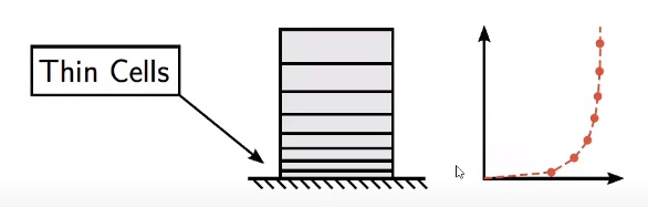

This is because of boundary layer formation. The velocity gradients are very steep in boundary layer thickness.
In order to attain and trace this nonlinear velocity profile with our piecewise linearly varying behavior in CFD, we should refine our mesh into very thin cells in this boundary layer region or near to the wall which sometimes may lead to reduce mesh quality.

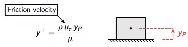

Y+ is the dimensionless distance normal to the wall. This is related to define mesh quality and helps in optimizing the mesh.

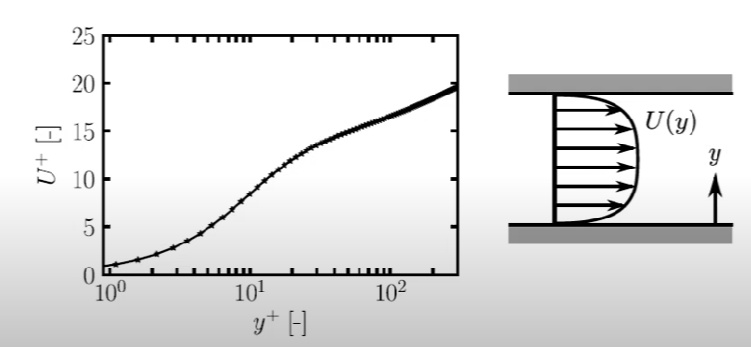

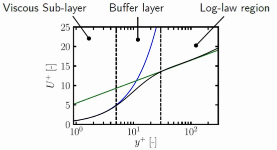

Law of the wall is universal plot between dimensionless vertical height (Y+) on logarithmic scale and dimensionless velocity (U+). This plot is applicable irrespective of any fluid and any flow.
The plot has 3 regions as in image attached down depicting regions in boundar​​​​​​​y layer near the wall.
It is observed that Y+ linearly with U+ in viscous sub layer region and logarithmically in log law region.
*Scale of Y+ is logarithmic because of which we cannot notice linear variation in viscous sublayer zone.
Here we can understand the role of Y+. The CFD code in background ensures to correct the fluid property, velocity at center of the cell attached to the wall with respect to the Law of the wall.
Always remember that the correction of velocity applied only to the cells adjacent to wall after that it follows linear variation between cells as mentioned in beginning and for larger values of Y+ generally where Y+ does not vary linearly with velocity. The range of this Y+ from where to be corrected depends on CFD code.

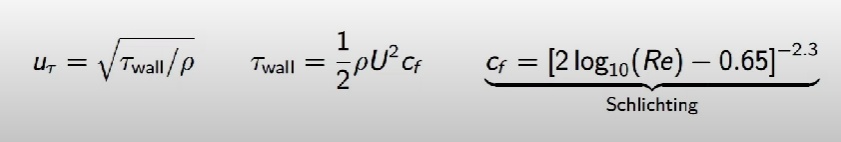

To predict the first cell size which is adjacent to wall, following relations mentioned in attached image are more often used.
