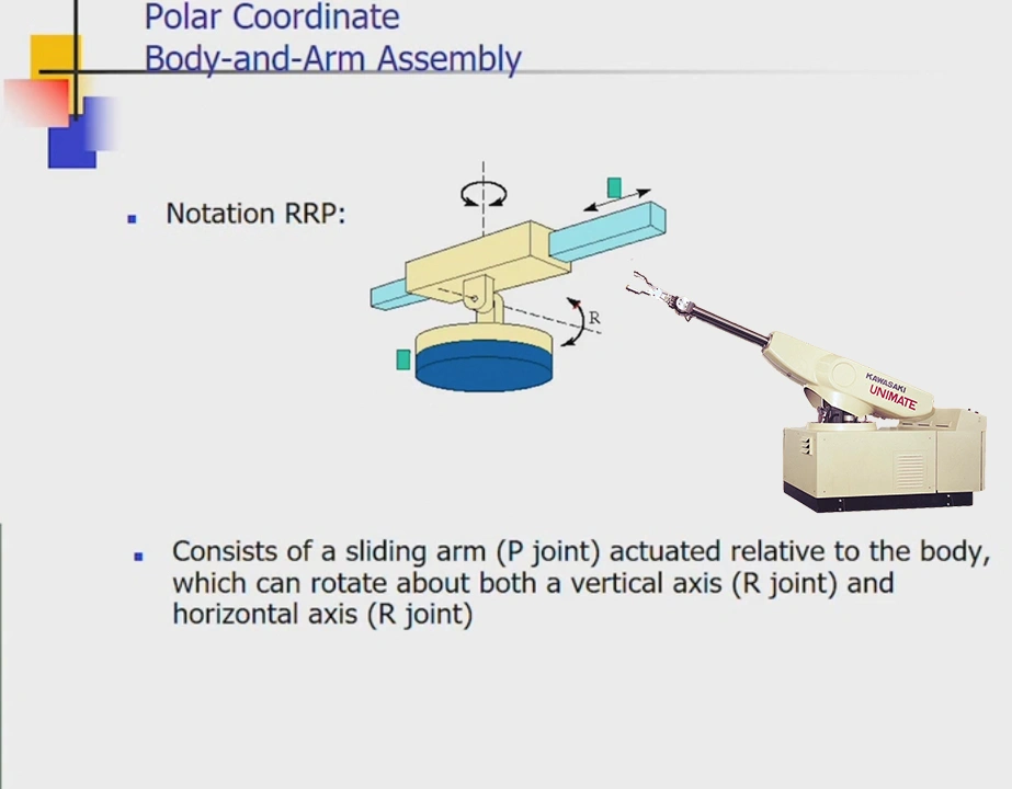

1- Polar coordinate body-and-arm assembly

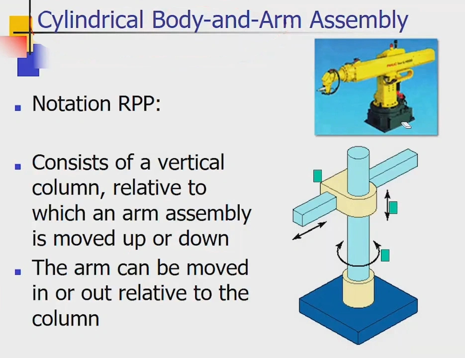

2- Cylindrical body-and-arm assembly

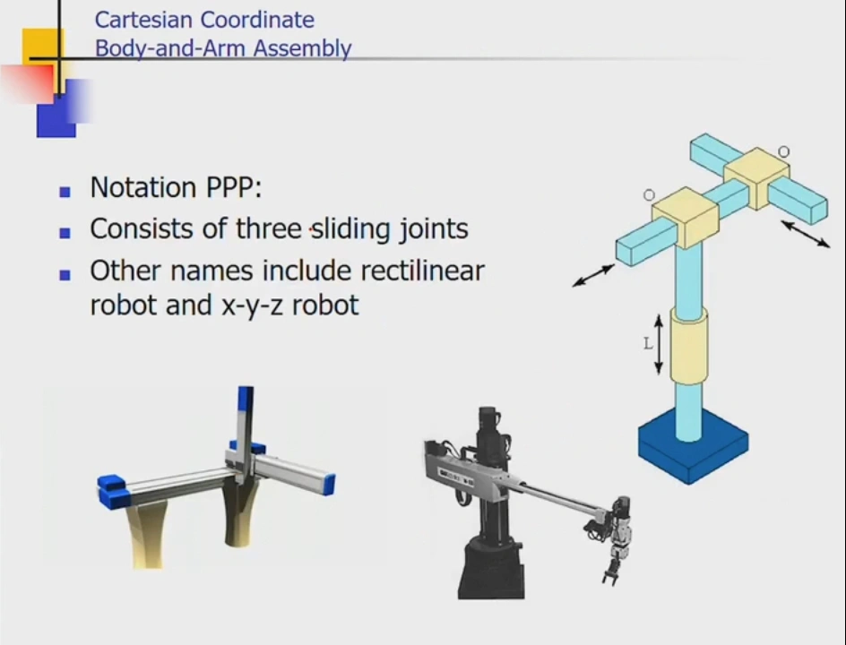

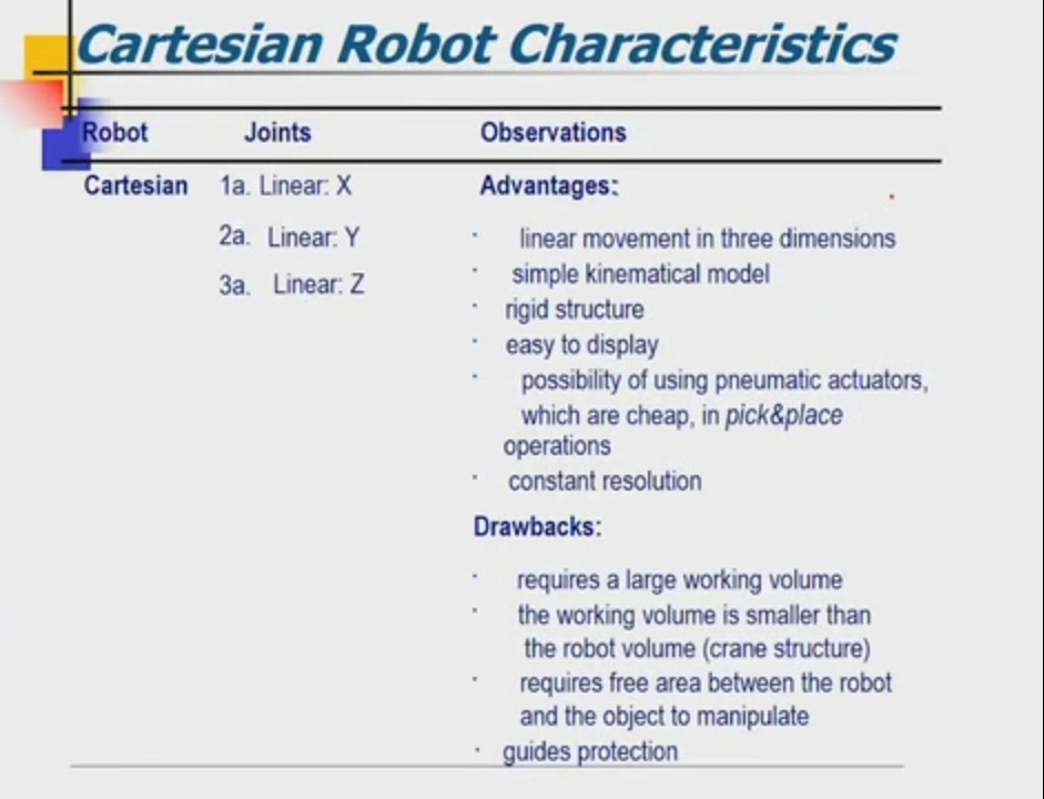

3- Cartesian coordinate body-and-arm assembly

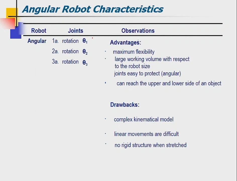

4- Jointed-arm body-and-arm assembly

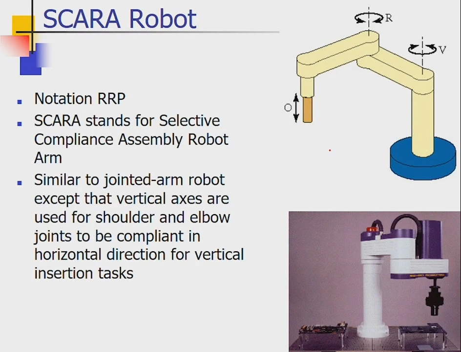

5- Selective Compliance Assembly Robot Arm (SCARA)
SCARAT stands for Compliance Assembly Robot Arm. SCARA Robots are similar to jointed-arm robots except that vertical axes are used for shoulder and elbow joints to be compliant in the horizontal direction for vertical insertion tasks.
