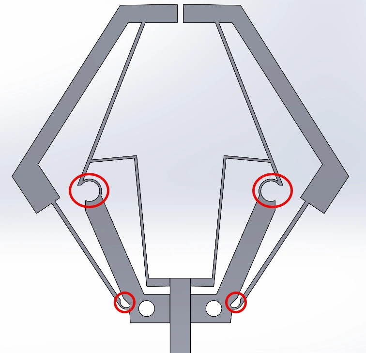

Traditional mechanical systems rely on pins, bearings, and hinges, which introduce friction, wear, and maintenance challenges. Compliant mechanisms, on the other hand, achieve motion through flexible structures, eliminating the need for traditional joints. This makes them lightweight, efficient, and perfect for applications requiring precision and durability.
In this design, It contains C-shaped flexural joints that bend elastically instead of relying on rotational movement. This allows the mechanism to store and release energy smoothly, making motion more precise and eliminating the need for lubrication or maintenance. The single-piece design also reduces complexity.

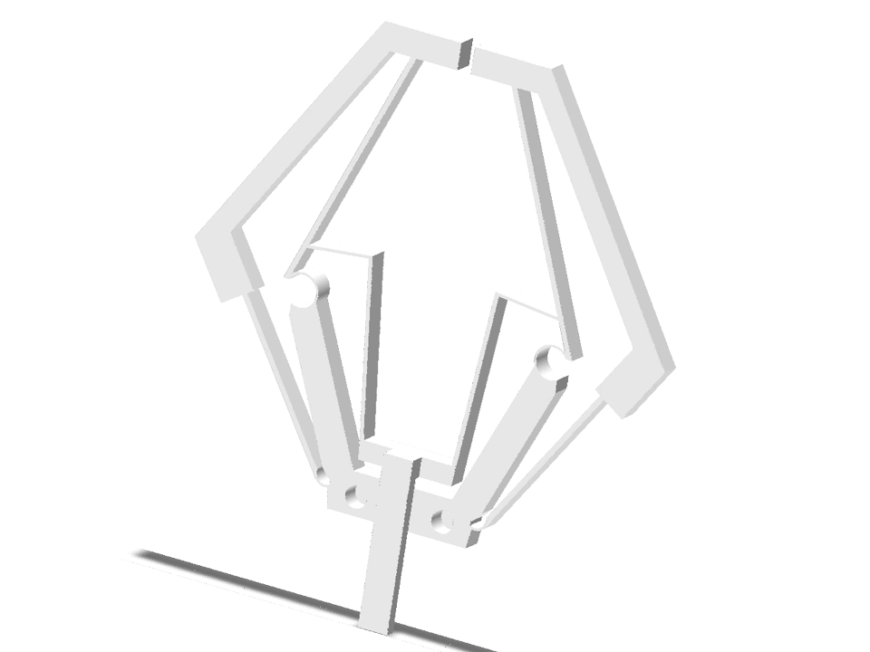

To bring this idea to life, I modeled the mechanism in SOLIDWORKS and optimized it for 3D printing. The result is a functional, efficient system that demonstrates how compliant mechanisms can replace traditional hinges in many applications.
Validating the Model:
You can validate your model using SOLIDWORKS Simulation to analyze stress distribution, deformation, and overall performance under real-world conditions. This ensures the mechanism functions efficiently before printing or manufacturing, reducing material waste and improving design reliability.
Check out the 3D model :
