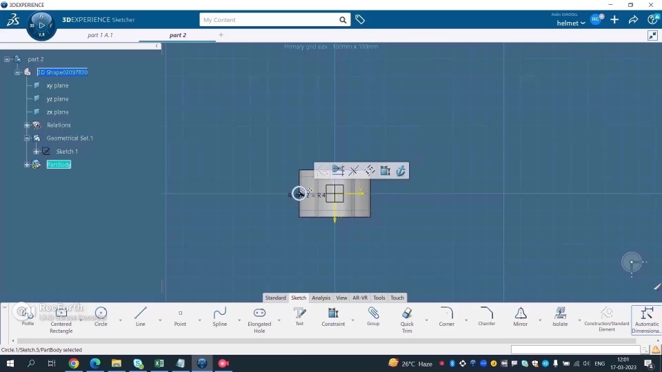

📌 The following video demonstrates traditional CAD Model creation:
- Modelling the upper and lower parts of connecting rod in part design.
- Creating relations within part design.
- Use of assembly constraints.

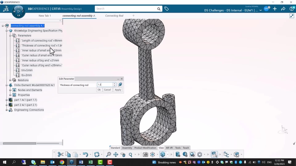

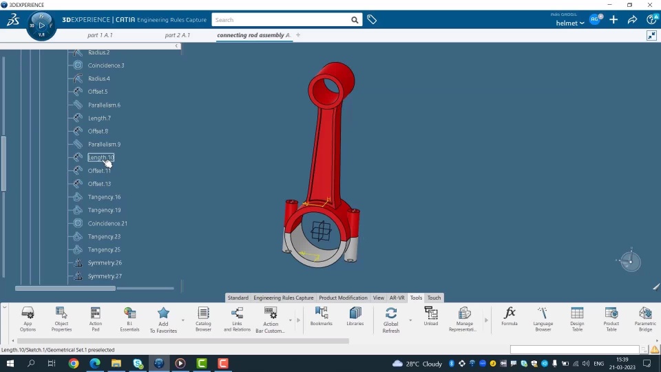

📌 The following video demonstrates:
- Creating Knowledgeware Parameters in assembly.
- Creating parametric relations within the connecting rod model and knowledge-ware parameters.
- Once knowledge-ware parameters are defined, whole assembly configuration can be driven by changing these knoweldgeware parameters to create various design alternatives using same base CAD assembly.
📌 The following video demonstrates how the structural mesh associated with the component gets updated by changing the parameters in Parametric CAD model.
- The main advantage of this approach is, there is no need to create a duplicate model as well as mesh for each design change.
