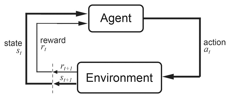

Reinforcement learning is one technique that is considered the forefront of the machine learning research effort. It differs from traditional methods of supervised learning (Eg. deep learning) as it does not require explicitly labelled data. Instead, an “Agent” (algorithm) is defined that interacts within the rules of a defined “environment”.
The Agent is allowed to choose from a set of predefined “actions” (decisions). The environment is programmed to give positive or negative feedback depending upon the action, such that after going through multiple “training steps”(iterations in the environment). The agent is able to “learn”(adjust the parameters of the function) to always achieve the favorable result by performing appropriate actions.

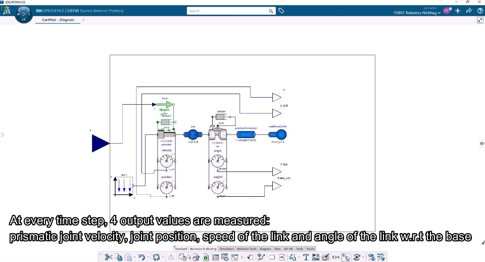

The nature of the assignment was interdisciplinary from the get-go. Both the physical and behavioural models were formulated by collaboration. Functional-mockup-unit in Dymola behaviour modelling worked as an interface between the platform and python scripting tools. FMU is a representation of the Modelica model (set of differential equations) that is packaged with the solvers for those equations. This black-box representation of the Modelica model can be interfaced with python or other industrial tools like Matlab. Python has specialized libraries for handling of the FMU. Once the inputs and outputs of the Modelica model are handled by python, a range of experiments with ML libraries can be performed. In this use case, I

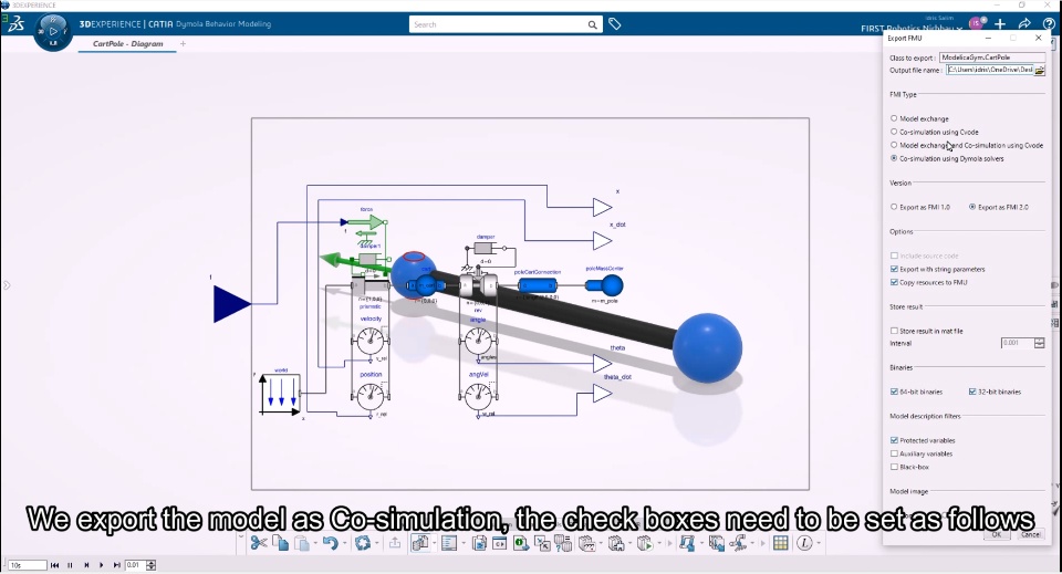

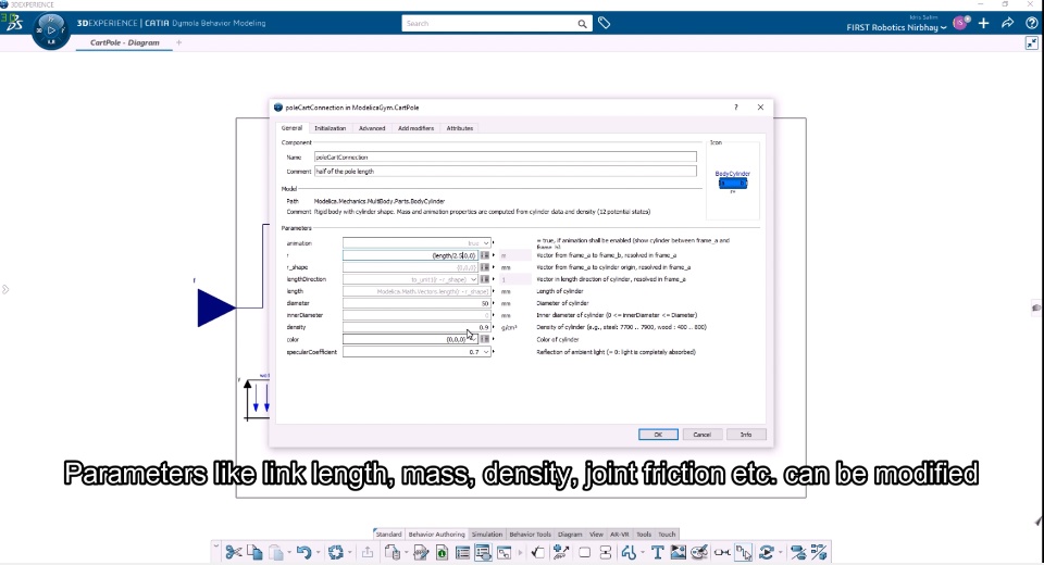

1) Modelled the inverted pendulum in DBM app.
​​​2) Edit the required parameters before exporting the FMU
3) Exported the model as a co-simulation black-box

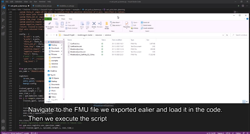

4) Loaded the FMU using python.

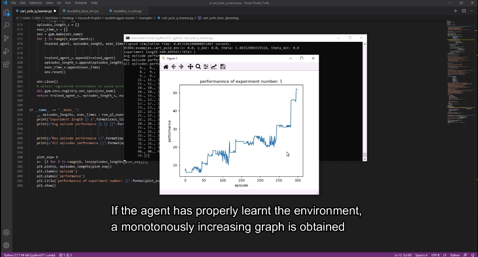

5) Ran the Q-Learning RL algorithm on the FMU(supply inputs to FMU and read outputs at each time step )to train the agent to stabilize the pendulum for maximum number of steps.
Steps 1-4 are to be used for any other type of experiment that needs to be performed in python. The Methods for handling the FMU are well explained on the official documentation of the PyFMI Library. Reference scripts in the published material also provide a concise explanation of the data flow.

My Mentor Ajinkya Naik guided me throughout the learning phase. The challenging task was to modify and implement the scripts that were designed by researchers on the assigned problem statement. This included searching for the appropriate libraries. I worked for approximately 4hrs-5hrs each week. I successfully tested the training of the Modelica model FMU in python, the results of which can easily be replicated using the published material.
