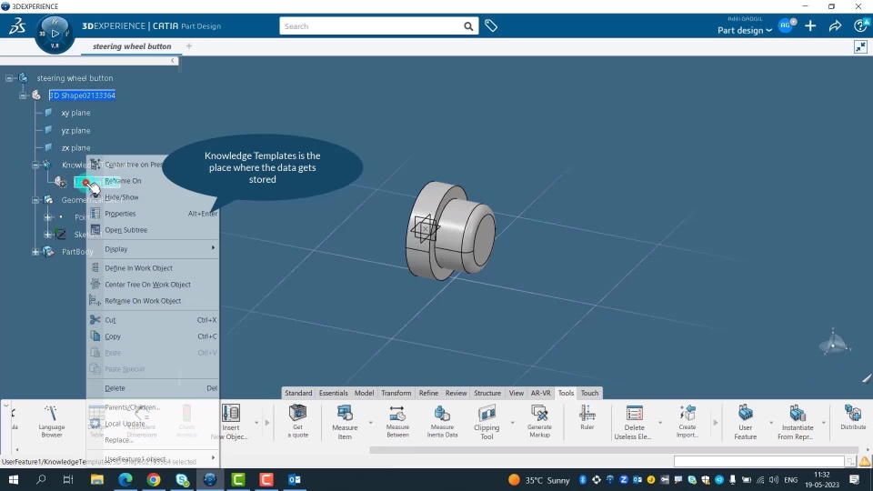

The User Feature creates a KnowledgeTemplate node in the tree which consists of child nodes that store the various User References (user references means properties of the feature).
One can parametrize the dimensions of these User References according to the need.
These User References are created in a part but can be then instantiated in same part or different parts as well.
