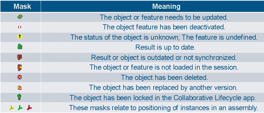

The tiny symbols that appear on your tree, to inform you about the status of that item in the tree, are called "Tree Masks".
If you are a user of 3DEXPERIENCE Native Apps you may have seen these at some point of time while designing/simulating, and wondered, what do they mean?
If you are a frequent user, you would understand some of them which are self explanatory.
However, you may eventually come across some, which you don't understand!
A quick guide about the frequently appearing "Tree Masks"
We have provided a link to the User Assistance below, which has a list of all the Tree Masks that you may come across. You can bookmark this link, to refer it whenever needed!
To see a complete list of all the Tree Masks, please click here.​​​​​​​
