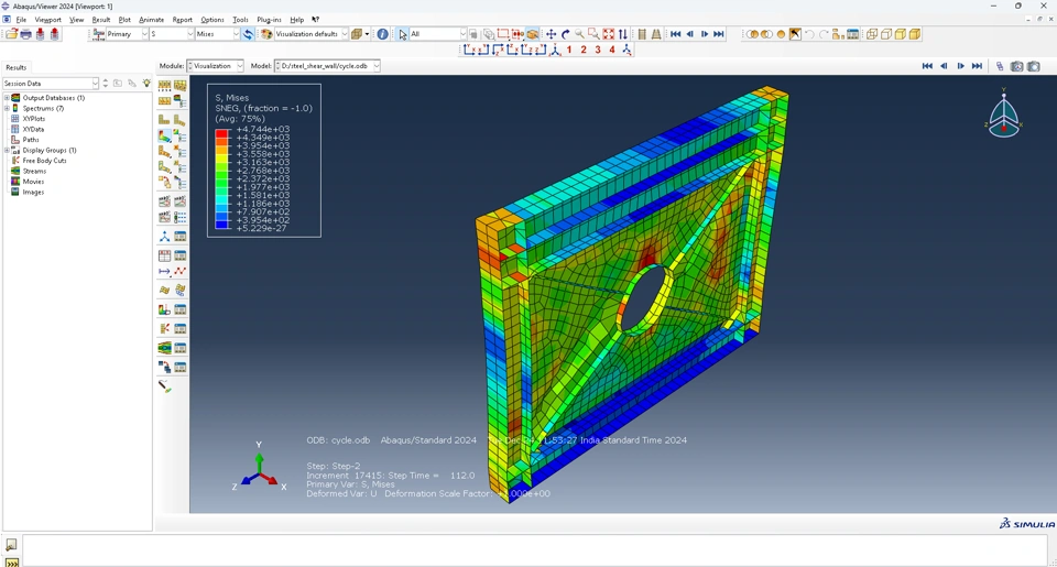

I performed a simulation from the Verification section of the ABAQUS documentation which has cyclic loading.
Now I would like to know the nodal deflections in the frame I need:
