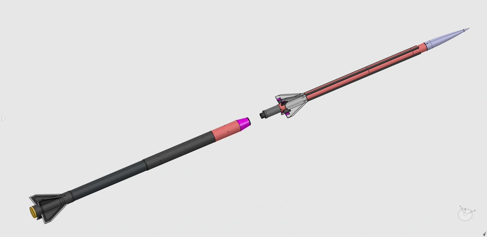

3DExperience CATIA render of the next design
